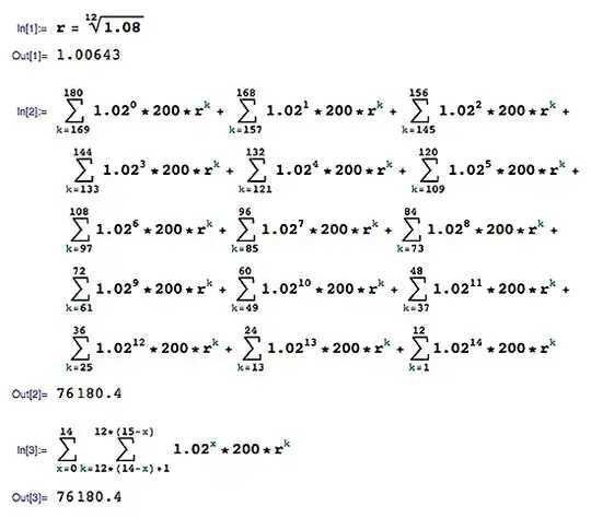

You can calculate it with the formula below, which is produced from a double sum.
P. S. The initial examples are for an annuity due (savings type annuity).
Future value = (r*(-1 + r^y)*(-b^(1 + a) + r^((1 + a)*y))*z)/((-1 + r)*(-b + r^y))
where
r = 1 + monthly rate = 1.08^(1/12) = 1.00643
y = months per year = 12
a = years - 1 = 14
b = deposit increase rate + 1 = 1.02
z = initial deposit amount = 200
(r*(-1 + r^y)*(-b^(1 + a) + r^((1 + a)*y))*z)/((-1 + r)*(-b + r^y)) = 76180.4
Mathematica was used to produce the formula from the double sum:

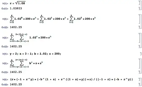

To illustrate the robustness of the formula here is another example with different period parameters: a twice-yearly deposit of 200 for three years, again incrementing annually by 2%, with 8% interest rate.
Running the calculation in four forms produces the same result. This proves the formula's robustness.
r = 1 + six-monthly rate = 1.08^(1/2) = 1.03923
y = periods per year = 2
a = years - 1 = 2
(r*(-1 + r^y)*(-b^(1 + a) + r^((1 + a)*y))*z)/((-1 + r)*(-b + r^y)) = 1402.25

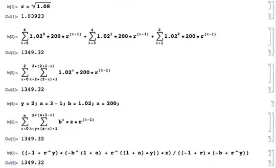

Recalculation for ordinary annuity (loan type), rather than annuity due (savings). - ref. Calculating The Present And Future Value Of Annuities
((-1 + r^y)*(-b^(1 + a) + r^((1 + a)*y))*z)/((-1 + r)*(-b + r^y)) = 1349.32

  • I think that only solves for when a=14, if you try different values for a (changing the number of years), you get numbers all over the place – plockc May 10 '14 at 18:25
  • I also have a different result for 15 years of 75963, not sure yet where the difference lies. – plockc May 10 '14 at 18:36
  • So the first term has 1.02^0 which is 1 making it the last year of interest being applied, but it shouldn't be r^k, should be r^180-k so that first payment of the last year gets r^11 interest compounding? – plockc May 10 '14 at 18:59
  • @plockc - Hi, the first term has 1.02^0 = 1 being the first year of deposits (at 200 * 1), which year's 12 deposits each accumulate 180 to 169 months of interest by the end of 15 years. Hope that clarifies things. I have added another, simpler example too. – Chris Degnen May 10 '14 at 22:05
  • Hi @ChrisDegnen, maybe we're applying stuff at different times? I am stepping through fv = oldfvr+2001.02^year, with rate at 1.03923, year being 0 twice, then 1 twice, then 2 twice, I get 200, 408, 628, 856, 1098, then 1349 as my answer. From the summation, I think I'm not sure why there is an interest applied at both the first (k=1) and last (k=180) month (so interest applied 180 times where I think it should be 179 times), is what you have an annuity due solution (first $200 deposit immediately)? – plockc May 10 '14 at 22:56
  • @plockc - You are taking r = 1.03923 which is the six-monthly example rate, so taking that simpler example's figures: 3 years, 6 deposits, over 3 years the first deposit builds to 1.02^0*200*r^6 = 251.942, the second to 1.02^0*200*r^5 = 242.432, the third to 1.02^1*200*r^4 = 237.946, etc. on up to six deposits. The first deposit rate term 1.02^0 is included so that the calculation for every deposit is a standard form for the sum expression. – Chris Degnen May 10 '14 at 23:33
  • I spelled out the simple example, dropped each exponent of r by 1, and ended up with a matching answer. From looking at it, you provided an annuity due solution as all payments are getting interest. If you could either regenerate with k-1 as the exponent of r, or divide the whole thing by (1+r) to back out the annuity due part, then I can accept the answer! Thanks! – plockc May 10 '14 at 23:39
  • @plockc - I've adjusted the interest term. Should be ok for an ordinary annuity now. – Chris Degnen May 11 '14 at 00:03
