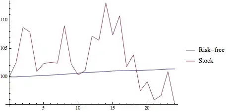

(* plot cumulative returns *)
crf = FoldList[Times, 100, riskfree/100 + 1];
cidx = FoldList[Times, 100, index/100 + 1];
ListLinePlot[{crf, cidx}, DataRange -> {0, 24},
 PlotLegends -> {"Risk-free", "Stock"}]
