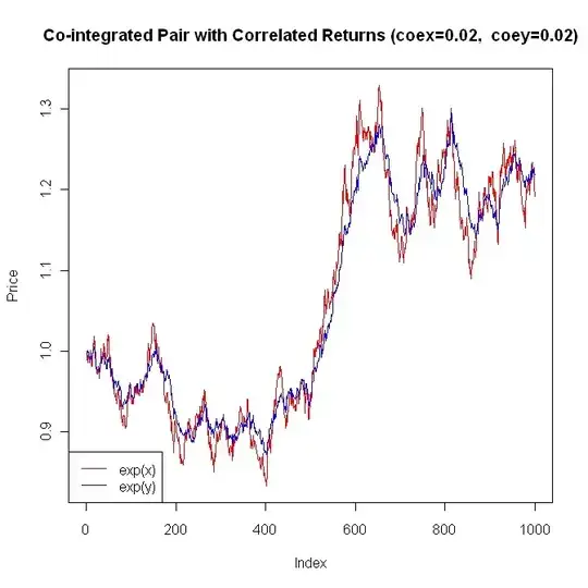

Edit 1 (04/24/2011) ================================================
The above deals with the correlation of returns, but as implied in the original question, in the real world it looks like correlation of prices is a more important issue. After all, even if the returns are correlated, if the two price series drift apart over time, my pairs trade is going to screw me. That's where co-integration comes in.

I need some code so I can screw around with things to make that definition meaningful. Here's my stab at a very simple version of co-integration. I'll use the same input data as in the code above.

Notice above, that the "co-integration term" for x and y shows up inside the "for loop":
x[i] <- x[i-1] + (coex * (y[i-1] - x[i-1])) + ranx[i-1]
y[i] <- y[i-1] + (coey * (x[i-1] - y[i-1])) + rany[i-1]
A positive coex determines how fast x will try to reduce the spread with y. Likewise, a positive coey determines how fast y will try to reduce the spread with x. You can tweak these values to generate all sorts of plots to see how those co-integration terms (y[i-1] - x[i-1]) and (x[i-1] - y[i-1]) work.
After you've played with this a while, notice that it doesn't really answer the correlation of prices issue. It replaces it. So, am I now off-the-hook for the correlation of prices issue?
Obviously, now it's time to put the two concepts together to get a model that is in the ballpark with pairs trading. Below is the code:

You can play around with the parameters and generate all sorts of combinations. Notice that even though these series consistently reduce the spread, you can't predict how or when the spread will be reduced. That's just one reason why pairs-trading is so much fun. The bottom line is, to get in the ballpark with modeling pairs-trading, it requires both correlated returns and co-integration.
A typical example. Exxon (XOM) versus Chevron (CVX), where the above model applies if some additional terms are added.
http://finance.yahoo.com/q/bc?s=XOM&t=5y&l=on&z=l&q=l&c=cvx
So, to answer your question (as just my opinion), price correlation is typically used/abused as an attempt to deal with the longer term divergence/closeness of the paths of the series, when co-integration is what should be used. It is the co-integration terms that limit the drift between the series. Price correlation has no real meaning. Correlation of the returns of the series determine the short term similarity of the series.
