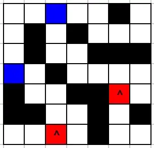

My solution:
N = 52

The optimal solution requires the robot to visit the bottom two corners (in either order) and then the top right corner
The top right slide forces an undesired move, adding 1 step
The bottom left slide is unused, adding 0 steps
The bottom right slow is used twice, adding 2 steps
The bottom left slow is used three time, adding 3 steps
6 total steps are added, yielding N = 52

Thus, improvement should come from an additional use of a slow square (bringing both to 3, which I don't think is possible) or using the second slide square to force an additional step.
  • Could you improve the solution by placing the sliders around (but not on) the starting square, pointing towards the start. That would force the robot a step back. – P1storius Jul 03 '20 at 08:05
    The blue square near top right is only crossed once, so the maze in the image has a score of only 49. A better solution is to place a slow square on R5C2 where it will be crossed three times. Also, moving the slide near top right one square to the right, pointing to the left, forces the robot to take an extra step. – Daniel Mathias Jul 03 '20 at 09:51
    @P1storius: The slides cannot be entered from the square toward which they point. – Daniel Mathias Jul 03 '20 at 09:53
  • Thank you @DanielMathias, I've incorporated your comments and adjusted the solution –  Jul 03 '20 at 23:21
  • Nice job! Seems like there are a few ways to get up to 52 steps then, even without optimal use of special squares, you had such a good map layout that it made up for it. Im guessing there is a limit where you trade the optimal map layout for optimal special usage, and vice versa. – Derager Jul 06 '20 at 13:20
A different approach to the slides yields an improved solution:
The optimal solution has the goal sequence of BL-TR-BR and requires a total of 54 steps.
