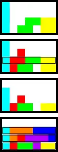

Level 2 is possible:
Level 3 is possible:

  • nice work - and bonus points for finishing Level 3 with a Tetris! One can also condense the solution by writing numbers in a grid e.g. 7666/5564/3554/3344/7322/7112/7112. Note that the 7's are connected once the 6th piece is played and three lines are cleared. – happystar Jul 03 '20 at 09:30
