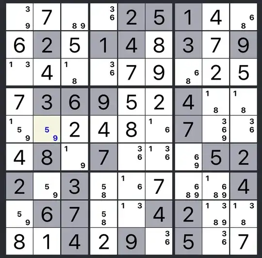

I'm working a program that should generate bad ass sudoku puzzles. Recently I noticed there's a thing called "logical sudoku", which means it can be logical-deducted all the way to solution. The problem is - I can't really tell if I added all possible deductions in my code.
This is an example of what I'v come up with so far (after all deductions I could think of). My question is - is this the edge? Or maybe I can add some more deductions to my code? Can you find another number here without guessing?
Here's a link to this state from my online program.

If r6c7 is a 6, then r3c7 is an 8. Also r6c3 is 9 (the only 9 left on row) r5c2 is 5, r7c2 is 9, and r7c7 is cancelled. Therefore r6c7 us a 9, and the puzzle can be solved.

    That's a correct distinction - but I'm not really sure it's a deduction... Feels more like guessing to me. Isn't it guessing? Like, how did you get there? you started writing down numbers to see if you get cancelled. No? – Shl Apr 15 '20 at 20:12
  • We've just had a Sudoku question about BUG's (https://puzzling.stackexchange.com/questions/97090/after-here-should-i-guess-or-is-there-a-logic-solution-on-sudoku) , which are chains of bivalued cells. This puzzle has a lot of them, so I figured if a BUG isn't going to crash, it must force a contradiction. I started with 3 in the top-left, but this solved it, so there must be a problem with choosing 9. This eventually forces the error above, and I managed to simplify it to it's minimal form. Once a pattern has been spotted, a computer can do the machine-like searching bit. – JMP Apr 15 '20 at 20:24

  • As I mentioned, my goal is to generate sudoku that can be deducted by humans without guessing. I want to add as much human logic as possible so it would be as harder as possible to solve. I think I did my best. Unless someone can show me another insight on the shared sudoku's state, without "guessing". (My definition of guessing is trial and error) – Shl Apr 16 '20 at 20:24
    If your goal is to incorporate as many human solving techniques as you can into your puzzle generator/rater then you may want to look for inspiration to existing tools like Hodoku or Sudoku Explainer. – 53x15 Apr 17 '20 at 02:35
