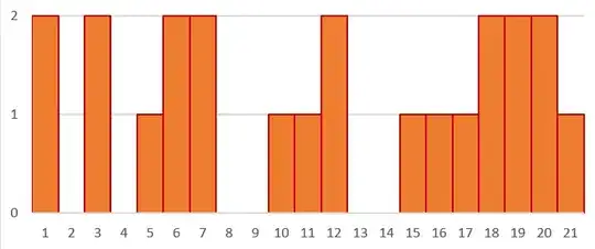

Following the second hint, we can now:
Treat these numbers as a dataset and plot each number's frequency of appearance as a histogram (to which there is a subtle graphical hint in the diagram itself, as a curved histogram-like shape can be seen among the purple plotted data points):
We can see from this that:
No number appears more than twice, and the range of the numbers is 21, which is divisible by 3 (and after all, the title tells us '3 is the key'...) - in fact it is 7 times 3, and we are looking for a seven-letter answer... so how about we try dividing this histogram into seven equal parts, and interpret each triple using ternary? So, dividing the histogram like this:
We can now extract the seven ternary triples: 202, 012, 200, 112, 001, 112 and 221.
These convert into decimal as: 20, 5, 18, 14, 1, 14 and 25.
And these then convert via A1Z26 into the final answer of TERNANY.

Partial answer, continuing from where @Rand al'Thor left off:
The points are:
$(0,1),(0,12),(1,0),(1,2),(1,5),(2,3),(3,0),(3,4),(4,3),(4,7),(5,1),(5,10),(6,4),(6,12),(7,9),(7,10),(8,10),(8,12),(10,2),(10,9),(10,11),(11,9),(12,7)$ (Thanks to @Rand al'Thor for doing the busywork here)
After this, the
sums of each pair are: $1, 12, 1, 3, 6, 5, 3, 7, 7, 11, 6, 15, 10, 18, 16, 17, 18, 20, 12, 19, 21, 20, 19$
Making
A histogram of the sums, we get:
 1   * *
 3   * *
 5   *
 6   * *
 7   * *
 10  *
 11  *
 12  * *
 15  *
 16  *
 17  *
 18  * *
 19  * *
 20  * *
 21  *
This looks
suspiciously like Morse Code, which I am terrible at decoding, so I'll stop here.

  • To incorporate the possible hint from the title three is the key I binned the histogram using the 3 yielding 7 numbers but I am not sure if this is a dead end. – 53RT Feb 20 '20 at 21:05
  • @53RT I also tried that but not entirely sure if it would lead anywhere - maybe encoded as ternary 3-bit digits, they mean something? – Avi Feb 20 '20 at 21:06
  • I think you were pretty close Avi - you just needed to include the whitespace in your graph (see my answer for what I think the intended solution is...). We were clearly working on this at exactly the same time! – Stiv Feb 20 '20 at 21:12
  • @Stiv I noticed the whitespace at about the same time that 53RT made their comment, but too lazy to actually compute that out :P – Avi Feb 20 '20 at 21:21
