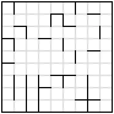

This is a Heyacrazy puzzle.
Rules of Heyacrazy:
  • Shade some cells of the grid.
  • Shaded cells cannot be orthogonally adjacent; unshaded cells must be orthogonally connected.
  • When the puzzle is solved, you must not be able to draw a line segment that passes through two borders, and does not pass through any shaded cells or grid vertices.
For an example puzzle and its solution, see this question.
This happens to be the first Heyacrazy I wrote, to see if the genre was viable. Diagonal borders hadn't been added yet, but there are still a lot of interesting deductions - this puzzle is an attempt to show off several of the ones that would appear often.
Deusovi

Solution (rather laborious):
Whenever we have one of those | patterns, at least one of the two cells it involves must be shaded. (Otherwise both of the ones on the other side have to be, and that won't do.) We'll use this a few times later. Obviously two diagonally-opposite cells of the + near the bottom right have to be shaded, and it's easy to see that whichever way around they go the two adjacent cells on the bottom are unshaded. Now, let's turn to the bottom left. Suppose the third cell in on the diagonal is shaded. Then its neighbours are unshaded, which gives us another shaded cell because of the T-shape, and now whether or not we shade the third cell on the bottom row the cell northwest of _that_one needs to be unshaded; that requires the cell to its left to be shaded and some other adjacent ones unshaded, giving the following configuration

  • That's correct! There's a nicer way to break into the bottom left without needing to dive deep into any hypotheticals, though. (I've given it as a separate answer, in case you're curious.) – Deusovi Aug 25 '19 at 00:01
  • Ah, yes, that's much nicer. I did have the feeling that I was missing a few lemmas for solving these... – Gareth McCaughan Aug 25 '19 at 00:13
Gareth has already given an answer, but the intended way to break into the puzzle is much less circuitous:
An important fact about Heyacrazy puzzles in general: an open wall (one that is unshaded on both sides) can never see two adjacent segments of a wall. This is because it would force both cells on the opposite side of the wall to be shaded, but those two cells are adjacent.
So, consider the walls marked in blue here.
One of the cells marked "A" must be shaded, because otherwise the horizontal line would be an open wall that sees the 2-tall wall immediately to its left (and force both Bs to be shaded).
So one of the cells marked "B" is unshaded, and so is the A of the same color (since both are next to the shaded A). If the other B was unshaded, then there would be an open wall that sees the 2-tall wall to the left of the Bs:
And therefore one of the Bs is shaded too.
The exact same logic applies for the Cs: one C and B of the same color are unshaded, and so the other C must be shaded to prevent an open wall from seeing a 2-long wall.
So an A, B, and C of the same color are all shaded. If it's the blues, the two walls in the bottom row can see each other. So it must be the green A, B, and C that are all shaded.
Then D and E are unshaded (to allow the bottom corner to reach the outside), then F is shaded, then G is unshaded, and you're halfway through Gareth's answer without needing to use any extensive case-bashing.
