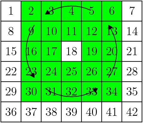

Larger variations exist. For example, here is a $16 \times 25$ board with $9 \times 9$ rotating blocks:
large
(A sample move's rotation is shown in progress)

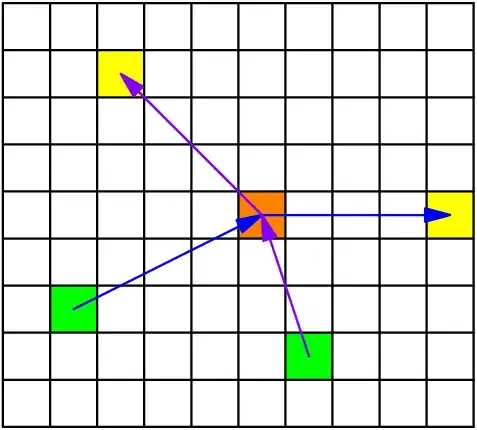

How would we come up with an algorithm like Spiral? Once again, we need to simplify our job. Can I send any number I want to the center square? If I can figure out how to do that, then I'm done! All I have to do is:
  1. Find the moves I need to move my number to the center.
  2. Find the moves I need to move the number in the goal square to the center.
  3. Do the moves in step 1, then do the moves in step 2 in reverse.
This will bring my number to the center, and then the goal square.
whoa
Now I just need to figure out how to bring my number to the center. The idea is that I'm going to come up with a nice procedure that will bring my number closer to the center. Then if I keep doing that, my number will keep getting closer and closer to the center. Eventually, it will be right at the center!

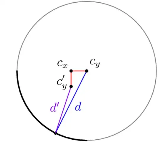

We need to figure out when the distance changed. It's when I did the X move:
spral4
The distance changed from $d$ to $d^\prime$. I need to prove that $d^\prime < d$.
spiral5
I only need to focus on the X move. Also, I marked the two centers of the board as $c_x$ as $c_y$. This will be very useful.
spiral6
I don't really care about the grid anymore. To help me out, I drew a circle at $c_y$ with radius $d$, because I know my number starts on the lower-left arc of this circle (in bold).

Next I needed to get rid of that X move and turn it into math somehow. Here, I turned it into an isosceles right triangle. This makes sense because during the X move, the distance to $c_x$ doesn't change, and it's a 90 degree turn.
spiral9

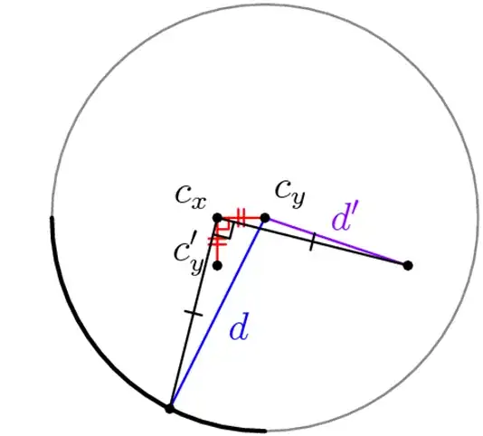

Here I'm going to do something tricky. I'm going to make a new point called $c_y^\prime$. It's the point you get when you rotate $c_y$ 90 degrees clockwise around $c_x$. But why would I ever make a new point? Well look:
spiral10
These two angles I marked are equal, right? You get both of them by subtracting a common angle from a right angle. But then...
spiral11
Amazing, these two triangles are congruent! That means...
spiral12
This missing length from $c_y^\prime$ to the number must be the same as $d^\prime$ by my congruent triangles! Now let's erase a bunch of the noise in my diagram:

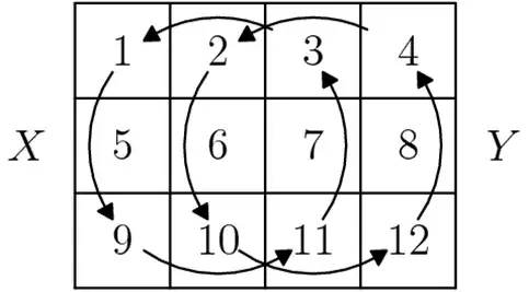

Before we go on, I want to look at one more algorithm, called Cycle. It's defined as: $$(YX)^4 = YXYXYXYX$$ It's a very simple 8-move algorithm. What does it do? Well imagine that there's some sort of "conveyor" belt running around the board:
belt1
Cycle will move all the numbers $n-3$ squares "counter-clockwise":
cycle2
It's actually not too hard to prove that it does this for all $n$. Something we call the "cyclic order" of all the numbers in the belt stays the same every time we do $YX$, and using some math we can find out how much each number moves after every $YX$.

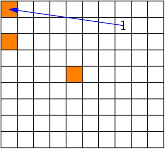

I will now describe, roughly, the Spiral-Cycle algorithm:
  1. Use Spiral to move the first number to the top-left.
  2. Use an alternating Spiral to bring the second number to the center of rotation of $X$ for odd $n$, or the upper square in the center for even $n$.
  3. If the first number was moved to the bottom-left due to the previous step, move it back to the top-left via $X^{-1}$ for odd $n$, or $X^{-1}Y^{-1}$ for even $n$.
  4. Use an alternating Spiral to move the second number to bottom-right corner for even $n$, or the square above that corner for odd $n$.
  5. If the first number was moved to the bottom-left at the end of the previous step, execute $X^{-1}$ to move it back to the top-left corner.
  6. Execute $XY^{-1}X^{-1}$. This will bring my second number to the second intermediate square.

First I do a Spiral to move my first number to the first intermediate.
sc2

Yay! That's our second PR. But we're not done quite yet! Because, there's a hidden third PR. Where could it be? It's actually something you get by "combining" the previous two PRs!
Remember that for odd $b$, all numbers stay in their own parity? And that, for odd $b$, all moves are even permutations? What if I analyze only how the numbers move in one of the parities? Is the permutation within a parity still even, or is it odd? If it's even, then each parity's initial permutation must be even for the board to be solvable!
parity4
This will be a little trickier. In total we know that $b^2-1$ numbers are moved. But since we're only looking at a single parity, we're only considering half of those. So we divide by 2, to get $(b^2-1)/2$ numbers moved, and then we divide by 4 to count the number of 4-cycles inside the parity, to get $(b^2-1)/8$.
Once again, let $b = 2k+1$. Then: $$(b^2-1)/8 = \frac{(2k+1)^2-1}{8} = \frac{4k^2+4k}{8} = \frac{k(k+1)}{2}$$ When is this even or odd? It's hard to tell. Well, $k$ is either even or odd.

Oof! Suddenly it's almost impossible! It's so cramped. There are only two rotations we can make, and each one moves around literally $2/3$ of the numbers! This is our hardest case because there's very little maneuverability. We should be analyzing this minimal case, the $n \times (n+1)$ board with $n \times n$ rotating blocks, because if we can figure out how to solve hard NRPs like this, then NRPs with larger boards (but same rotating block size) should become pretty easy.
For future reference, we're going to call the move on the left $X$, and the move on the right $Y$. $X$ means a single turn counter-clockwise, $X^2$ means turn it twice, and $X^{-1}$ means turn it clockwise. $XY^2$ would mean do $X$, then $Y$ twice.
Alright, now we have a clear goal in sight. How can we find a general 3-cycle algorithm in the hardest case? Actually that's kinda hard, right? Let's see if we can tackle something easier. How can we find any 3-cycle algorithm in the hardest case? If we can't do the latter, we definitely can't do the former, so this is a good place to start.

If $n=4$, use $XY^2X^{-1}YX^{-1}Y^2$. Otherwise, for $n \geq 5$:
  • If $n$ has a remainder of $0$, $1$, or $2$ when divided by 6, use $XYXYX^2Y^2X^{-1}Y^{-1}$.
  • If $n$ has a remainder of $2$, $3$, or $4$ when divided by 6, use $XYXY^2XY^{-1}X^2Y^{-1}$.
  • If $n$ has a remainder of $5$ when divided by 6, use $XYXYXYX^2YX^2Y^2$.
By lots of testing, I found that these rules work for all $n$ up to 200. How would I know if they work for all $n$? It's provable but kinda annoying, so I'm leaving it out. Basically, we need to figure out how each of these algorithms behaves, and prove it behaves that way no matter how big the board is. Then, based on the behavior, we need to figure out the lengths of each cycle in the algorithm's permutation's cycle decomposition in terms of $n$.
