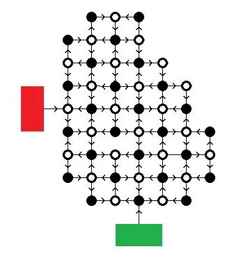

Consider the following maze.
an image of the maze
You can walk on the black lines, and your aim is to go from the green at the maze's bottom to the red on the left side. However, each time you reach an intersection of three or more black paths (spokes), you must turn 90 degrees either direction, rather than continuing straight.
Find a valid path through the maze, or prove that no such solution exists.
  • It's not a puzzle; the solution is not a trick.
  • If you arrive at a corner, simply follow the path.
  • You cannot suddenly turn around and walk the other way, but you may retrace your steps otherwise.
  • It's a puzzle of my own creation, and I already have the solution.
  • The missing line in the middle of the maze is intentional.

Here is an answer that I think is slightly easier to understand:
I have marked all the intersections with a white or a black dot in the manner of a checkerboard. Whatever path you travel, the intersections you visit will alternate black and white. Since you also have to alternate your direction of travel at every intersection between east/west and north/south, it is easy to see that when you arrive at any black intersection, your next move is east/west, and at a white intersection your next move is north/south. The only way to reach the red block is west from a white intersection, which you will therefore never be able to do.
To hammer the point home, from the restrictions above it follows that each edge can only be traversed in one direction. In the following picture I have marked each edge with the travel direction. As you can see, the edge to the red block has the arrow going in the wrong direction.
