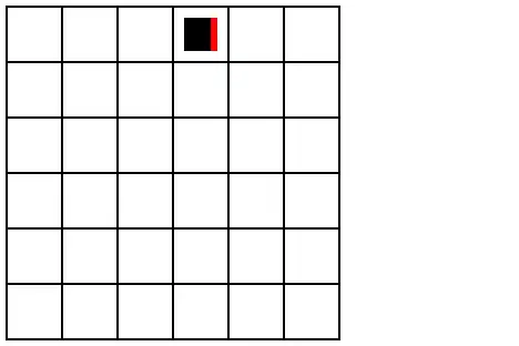

Here is the warehouse. The single barrel is standing up with red paint on the side facing right. Please show how to paint the whole floor by just moving the barrel around, and without repainting any squares. You are not required to do so in the minimum number of moves.

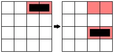

Let's make Building Block 1!
The goal for Building Block 1 is a sequence of moves, in a 4x4 region, that moves the barrel lying right on its painted side in a corner, to lying right on its painted side two spaces below that, without painting anything else in between.
There may be shorter sequences than this, but the one I used was 20 moves long: "DDDLUURDLDRRULDLURDR". (Given how many times this block is repeated in some fashion, any improvement here is represented twelvefold in the overall sequence.)

Building Block 2!
The goal for Building Block 2 is a sequence of moves, in a 4x4 region, that moves the barrel lying right on its painted side in a corner, to lying right on its painted side three spaces below that, without painting anything else in between. (In the strategy, it's first used to move the barrel up rather than down, but this can be done by swapping every "up" with "down" and vice versa, to get a vertical reflection that moves up three.)
One sequence that works here is 10 moves long: "DDDLUURDDD". This specific sequence probably can't be improved, and it's actually nicely symmetrical.

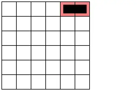

Because the paint is on the side of the barrel, covering the 36 floor tiles has to be done in 18 parts. In both strategies, the 18 parts are always 3 in each row, but this is not the only way it can be done.
The original order of the 18 parts (left) and the new order (right) are pictured below:
