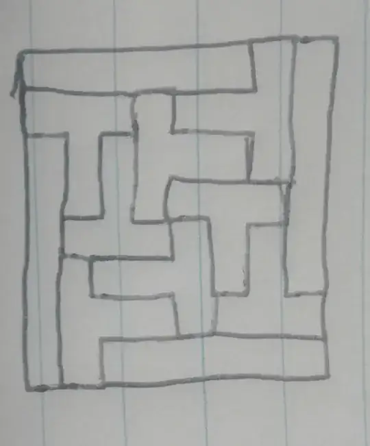

Here's three of them
$3\times 6$ tiled with $1\times 4$
$4\times 4$ tiled with $1\times 3$
$8\times 8$ tiled with $1\times 6$. Not sure if optimal.

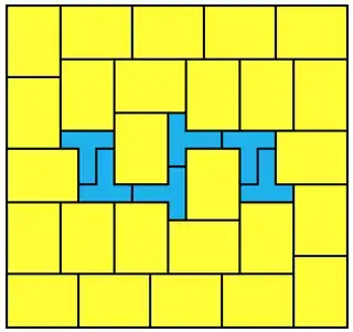

I assume these are the remaining ones you found as well; for 2x3
a simple 7x5 = 35 one:
for 2x2
a 10x8 = 80 one
for 1x5:
11x10 = 110
for 2x4:
14x22 = 308
for 2x5:
12x15 = 180
for 3x4:
18x19 = 342
and finally a large one for 3x5
which uses the same central figure formed by the Ts as the 1x5.
28x40 = 1120
