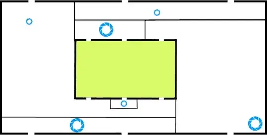

This question already has very good answers, but I wanted to share my intuition for why the given maze has no solution. This is a visual approach to the problem that I find a lot easier to grasp. It is however not a rigorous proof.
This approach strives to demonstrate that the maze is equivalent to two disjoint paths infinitely spiraling towards each other. The following "tricks" will be used repeatedly in this demonstration:
  • Walls that do not separate rooms can be removed
  • Walls can be stretched in any way as long as they do not create new rooms or remove old ones (this includes stretching a wall out of a single point and squeezing a wall down to a single point assuming it does not violate the create/remove room rule)
  • If two rooms are connected by a portal, any walls that only serve to separate those two rooms can be removed
  • If a room has more than one of the same portal, all but one of that portal can be removed
  • Portals that do not lead to any other rooms can be removed
Repeated application of these "tricks" will leave only disconnected components of the maze.
Let's begin.
First let's look at the original maze for reference.
We can remove all of the unnecessary walls to clean things up a bit.

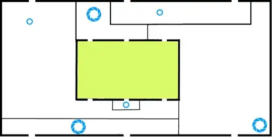

In order to better see the spiraling paths at the end I think it's best to stretch the maze out into a rectangle. We will start doing that now with the outer edge. Since this removes the distinction between the entrance and the exit of the maze we will just have to remember that the doors at the top are the entrances and the other outer doors are the exits.
At this point let's also clean up all of the squiggly inner walls and make them straight.
As I mentioned before, I would like to stretch the maze into a rectangle shape. So now is a good time to start working on the inner copy of the maze. We start by rotating it until it is parallel with the outside.
Then we stretch it into a rectangle to match the shape of the outside. (Ideally to make this demonstration a bit more rigorous we would be simultaneously modifying the inner and outer shapes of the maze so that they are always the same. However I think that would be a lot harder to follow. In any case, the inner and outer shapes are the same after this step)
Now let's move the left-side door on both the inner and outer part of the maze to the bottom, and also make everything nice and centered.
We are very close to being able to see the spiral shape. Let's stretch the top-right room to add an explicit wall between the top-right and top-left rooms. We can remove this wall in a later step. This step also serves to make whole layout look more symmetrical.
The spiral becomes evident once we remove all of the walls between rooms that share the same portal.
And then remove all of the duplicate portals in the same rooms.
The portal on the right no longer goes anywhere so we can remove it. We can also start looking a level deeper.

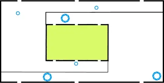

Again let's remove any unnecessary walls and portals.
From here we can just repeat the process indefinitely.
The path starting at the top at the entrance and the path ending at the bottom at the exit never meet given that the maze repeats itself infinitely. They just spiral around each other towards infinity.
