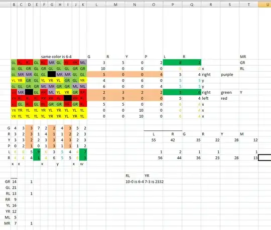

My guess is, from top to bottom ?? we have
M>, G>, R<
Non-spoiler paragraph would read that I tried to match the pattern of colors vs the left/right ratio between the rows and the columns of the table.
First
It makes the row read 5,0,0,5 for colors and 5,5 for L/R. It affects the column to go 6/4 L/R because we've already matched the 3/7 with the second elephant. It affects column colors to 2,1,3,4
Second
To go 3/7 R/L would match the final column's 3/7 with 2,3,3,2
Third
All rows the same color are 6/4 L/R, so match the pattern
This is mostly guess-work, but you can see my (convoluted) work with this image:
Raystafarian
