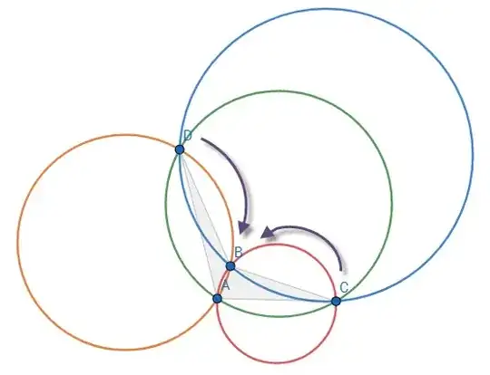

4 soldiers, convex setup
If they form a convex quadrilateral, I think they can successfully infiltrate with a probability of 1 using the following strategy:
Upon waking up a soldier looks at all the possible triangles and their circumscribed circles. The meeting point will be the clockwise extremity of the longest arc of the circle that has the greatest diameter.
Soldiers who wake up on that circle will travel on it counterclockwise. The soldier who doesn't, can travel clockwise (I think) on any of the 2 circles that go through him and the meeting point. Traveling in a straight line for him wouldn't work because it could create a situation close to alignment, and possibly changing what will be the meeting point for another soldier waking up.
In the example below, CAD has the largest circumscribed circle, C is the meeting point, and B can travel on ⌒BC clockwise on any of the blue or the red circle without compromising the success probability of the infiltration.
4 soldiers, concave setup
When the quadrilateral is concave, traveling to the same point as before can be dangerous because 3 soldiers may get close to alignment and mess up the meeting point for other soldiers when they wake up. On the other hand, traveling towards the concave point seems to work, both on a straight line or on one of the circle paths, provided that the soldiers choose the path that doesn't invert convexity.
On the example below, A, C and D can easily travel to B without breaking the concavity of the quadrilateral.

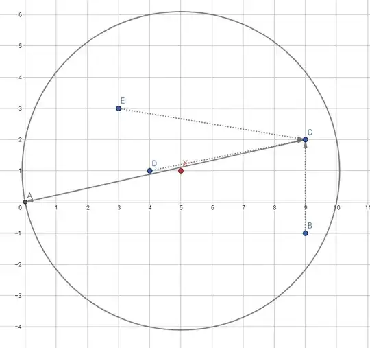

Here is my methodology including they can wake up any time and without using compass etc:
First of all, I will try to explain my methodology with an example and make it general:
This is our initial condition, where you can see anyone in their map. let say E wakes up and the rest is still sleeping, or does not matter if anyone has already started to move according to the method, but for simplicity I will make E moves only for now.
E will calculate the center of their position with putting a simple coordinate system on the locations with the formula below:
$Avg_{CoorX}=\frac{C_1x+C_2x+....}{Num_{soldiers}}$
which is simple average of X and Y axes values. As example, I put a random coordinate system on their locations, but whatever X and Y axes you use, it will be the same result:
I took the reference point as $A$ for $E$ and find the mid point using their coordinates and draw a circle where it covers everything as below:
So our furthest point to the center is $A$, and it could be any point anyway but that's the point where they are going to meet but how?
This is a tricky part because if "let say" $E$ wakes up and starts to move to $A$, the new furthest point to the middle point may change to $B$ or $C$ as you suspected. So $E$ cannot move to $A$ for sure. So where can he move?
Here is the tricky part!
$E$ will move straight to furthest point from $A$ which is point $C$ in this condition. As a result $A$ will be always furthest point from the center point soldiers calculate after they check their GPSs. And everybody knows (including $C$) $C$ is the furthest point from $A$ always! So if $C$ or $D$ or anyone wakes up while $E$ moving, $A$ being the furthest point from middle point and $C$ is the furthest point from $A$ will not change.
So:
  • $A$ will not move at all.
  • C will not move until the rest arrives to his location
  • The rest ($B$,$E$,$D$) will move to $C$ directly without making more distance from $A$ than $C$.
    • After they all made to point $C$ (They will wait the rest arriving to $C$), they will move together to $A$.
I believe this methodology will always work whenever they wake up. In more general:
  • Wake up and find the center point on the GPS, find the furthest soldier ($F_1$) to the center, find the further soldier ($F_2$) to this one.
  • $F_1$ will not move at all.
  • The rest (except $F_1$ and $F_2$) will move to $F_2$ directly without making more distance from $F_1$ than $F_2$.
  • After they all made to point $F_2$, they will move together to $F_1$.
Though there are some possibilities where there are more than one $F_2$ and more than one $F_1$. But there is tweak for these conditions:
What if there are more than one $F_2$ but unique $F_1$,
The rest (except $F_1$ and $F_2$s) will move to nearest $F_2$s, then move to the other $F_2$ in a straight line, so there is no way they will miss other soldiers after a while and they know how many soldiers are not $F_1$. moreover a single movement to another $F_2$ will favor the destination $F_2$ since the distance will be shorter because they move straight.
What if there are more than one $F_1$,
There is also no problem using the same methodology where "$F_1$s don't move until someone reaches them.". Because even a single movement from anyone will change the center, and $F_1$ will be unique. Here is an example:
Let say this is initial condition and a soldier wakes up and see this condition. There are 3 $F_1$s and one $F_2$s for each $F_1$. Probably one of the worst condition possible but if any soldier moves even like a inch, there will be a unique $F_1$ and unique $F_2$ because the center will automatically change. For example, let say a point in the circle wakes up and see this condition, he is furthest from one of the $F_1$, but if he even moves a inch to any other furthest point, the middle point will not favor his $F_1$ anymore and there will be a unique $F_1$. The rest becomes the same methodology above.
Please ask me any question regarding to this methodology, I will edit this answer accordingly. But l believe this will work with any conditions.

    The bomberman can change. For example, suppose there's an almost right-angled triangle ABC with almost-right angle at A and AC>AB. Specifically, the angle at A is less than 90. Now C wakes up first. As C walks towards A, when C is just near the foot of the perpendicular from B to AC, B wakes up. The bomberman, from B's POV, is C. Thus B moves towards Cs new location, and the detonators explode in different places. – Wen1now Sep 30 '17 at 11:17
