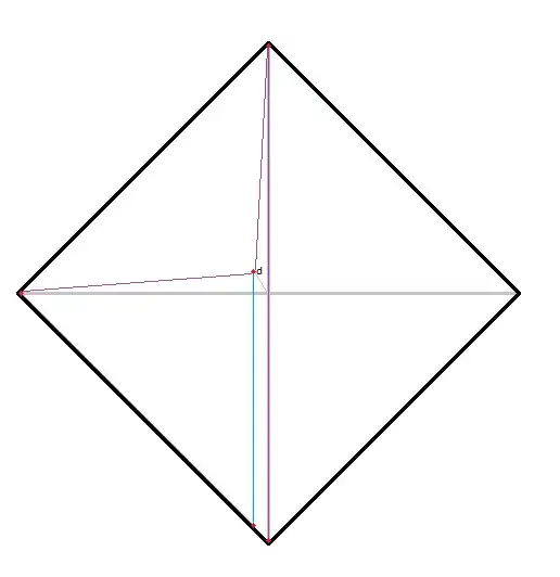

  • What is "left" and "right" of a knight? I'm thinking of some positioning, which will leave The angle always > 90, but I can't fully understand the formal procedure to proceed with my examples.. – klm123 Jun 06 '14 at 17:41
  • I mean you draw the minimum angle which would encompase all houses. This angle could extend behind the house and be greater than 180 if you can come up with a good one for that. – kaine Jun 06 '14 at 17:43
  • so the knight takes responsibility for an area and all houses in it. each time he draws two closest lines (one would be called left, one is right, but this doesn't matter), which limit all "his" houses? – klm123 Jun 06 '14 at 17:53
  • "his houses" are the ones that are on his current map. He is trimming the map down to remove the area that does not have any houses on it before he cuts it in half for the the house seeking trip. I'll drawn an example. – kaine Jun 06 '14 at 17:59
  • Why is 2 the maximum time in step 4? – justhalf Jun 26 '14 at 03:20
  • Because I am aware that there is a map that yields 2 for that step. I believe that is the maximum for several reasons but am not statisfied with my ability to prove it. If you can prove that statement, you prove that the maximum time for any arbitrary map is $2+\sqrt {2} $. – kaine Jun 26 '14 at 12:53
  • If I understood it correctly it's a nice idea but it doesn't work: take a spiral that start in A and put points on it very close one to the other. At each new point one knight give up and the other follow the spiral leading to a length of more than $2 + \sqrt(2)$ – Ara Aug 14 '14 at 15:02
  • @Ara I'm not convinced I'm wrong; I probably miscommunicated. Unless there is only one house left on a a map, there is no reason one knight would give up and one would continue. How do you think you can design the field such that one knight quits every time? No matter what each knights map at least halves in size at least each time he hits a house which is the crux of the idea. I'm not saying your wrong but I'd like to know more. – kaine Aug 14 '14 at 15:36
  • If I have a spiral like that: http://imgur.com/cpB9fYe Then locally it looks like this: http://imgur.com/HdNQ6C8 If it's the case then I feel like you'll go around much of the spiral, which can be arbitrary long. Did I miss something ? – Ara Aug 14 '14 at 16:08
  • @Ara The first house right after the castle will cause there to be 2 knights. The map will be cut in half along a line that goes though the first house and (roughly) the center of the spiral. One knight will recieve the bottom half of that map and will go to the next point along the spiral. The other knight will get the top half and go to the closest point to him on that map. No knight will end up following a path that looks like a spiral though several will follow one that goes along a curve. – kaine Aug 14 '14 at 16:55
  • @Ara I think from the local one you think they cut the entire map in half based along their last path? They trim the map carried by the knight who went to their current location so no knight gets an empty map. They then bisect that map into equal area sections. Each half by this method always has at least one house on it (unless there is 1 house or 0 houses on both halves of the map total). – kaine Aug 14 '14 at 17:00
  • Thanks, I think I get it now. I'll try to see If I can come up with a proof than your strategy work in finite time. – Ara Aug 14 '14 at 18:57

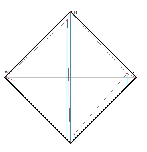

In the example above (which only shows the house covering part of the algorithm), purple is the paths knights take, blue the region dividers, and red the houses. If the houses not at the corners are $0.05$ from the corners and $22.5^\circ$ degrees from the edge, it takes $1.42$ units of time to go from N to S and $1.004$ units to get to either other corner.
This second example does not work by this algorithm. If the house near the south corner is slightly to the west of the house near the center (labeled). The limit of the time to complete this algorithm as d goes to zero is: $2\sqrt{.5}+1 \approx 2.4$. Several other knights are available to get to that last house before the knight that does but is not defined in the algorithm.

  • The most simple explanation: Each time a knight reaches a new house, he splits his region into two halves vertically (note I am visualizing this as a square diamond), keeps half for himself and gives half to the new knight, and both go to the northmost house in their region. – kaine Jun 03 '14 at 13:23
  • Yes. You draw the example I meant. But the paths looks very odd to me. Why on the picture the start is at S? The start point is the centre and they all should go back to the center afterwards. – klm123 Jun 03 '14 at 13:44
  • The start for this diagram is at North! I did not include them going to the center nor from the center as that would clutter the diagram. The essensce of this answer is to go from the extreme corner in less that 2, get to their starting point in $\sqrt {.5}$ (trivial), and back to the castle in $\sqrt {.5}$ (again trivial). – kaine Jun 03 '14 at 13:49
  • Upon rereading it I realise I may not have been clear that my goal was to determine an algorithm by which any finite map of houses could be reached within the lower bound for the minimum time that is defined in Step 1. – kaine Jun 03 '14 at 14:04
  • I understand the picture now. Thank you. The algorithm I understand too, I hope. But the prove is not clear to me. Why "the shortest path connecting the north and south corner houses via this algorithm will be taken. The maximum distance for this shortest path is 2."? There can be many houses on the path to south. – klm123 Jun 03 '14 at 14:28
  • Also it is not clear what to do if there no house in the very North (in the corner). Then distance to East can be longer. But this is a good hint in any case, so I give it +1. – klm123 Jun 03 '14 at 14:29
  • I've found a way this algorithm does not work but it was because of my attempts to simplify it after I had already written the answer. I had orginally had knights attempt to use diagonal region cuts rather than vertical ones. If there is no house at the North most corner, use a corner that has a house. If no corner has a house, use the furthest point away from the castle. I've not tested this. – kaine Jun 03 '14 at 14:35
