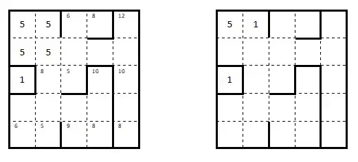

Grid 1: Slitherlink $+$ Sudoku (i.e latin square)

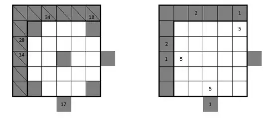

Grid 2: Kakuro $\div$ Skyscraper
Grey squares mean that nothing goes there for the Kakuro ONLY, and also the Kakuro has the additional property that no two squares are the same horizontally, vertically or diagonally including through the center square.
$\color{red}{\text{user39583 proved that this puzzle's ambiguous; see his solution for the intended sol.}}$ (don't forget to +1 his solution!)

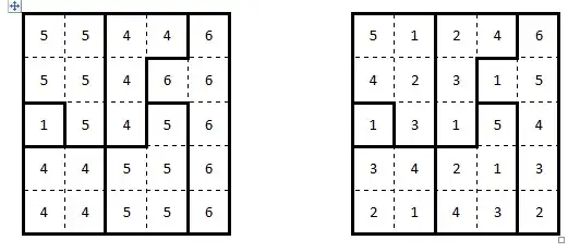

Grid 5: Fillomino $+$ Ripple effect
Ripple effect regions are fillomino regions.
3 is the maximum cell value in Slitherlink and 5 in Sudoku so 8 = 3+5 giving also 7 = 3+4, since the 5 in Sudoku is already taken on that row. Because the loop in Slitherlink cannot touch itself, we can also deduce some borders around the 3s.
If the upper right corner had a 5 in Sudoku, it would have a 1 in Slitherlink, which could only go below the cell. This would eventually force the border to form a small loop in the last column, because of the 3 there. Therefore the only possible place for the 5 in the first row is the first column. This also gives the remaining 5s.
Due to the 0 in the first cell, there is only one border that can be filled for the cell below it, and because the corresponding cell can have at most 4 in Sudoku, it must have 1 in Slitherlink. This also gives the borders and numbers for the cell below it.
After this it is fairly straightforward to fill the Sudoku starting with the first column, then filling the 4s, then 3s and then the rest.
Then it is easy to fill the slitherlink starting from the first row and going downwards.
Slitherlink+Sudoku solution
Some of the numbers cannot be multiplied in Kakuro, so we know that they are 1 in Skyscraper and must therefore have 5 as the nearest building. After this the second column and second row cannot have 5 as their nearest buildings so they must see at least two buildings, but neither of them can be multiplied by more than two in Kakuro.
The fourth row and fourth column must be multiplied by at least three so we can deduce the last two 5s in Skyscraper. The second column must contain the numbers {4,6,7,8,9} and the last two numbers in third column must be {8,9}, so we can deduce that the last rows multiplier must be 3 and the fourth rows multiplier must be 4 (they cannot be more due to the skyscraper 5s). Also this means that there is no possible way for the third columns 9 to be in the fourth row, which gives the placement of 9 and 8.
The remaining numbers on the fourth row must be either {1,2,3,6} or {1,2,4,5} and the 14 on the third row must be due to diagonal limitations either 8+6 or 5+9. If it were 8+6, the only possible order for the second column would be 8,9,6,4,7, making the last number on last row a 2. Since the fourth row must also contain a 2, it would have to be in the first column, but then the remaining number of that column would have to be a 2 as well. Therefore it follows that the 14 must be 5+9.
The last number on the fourth line can be at most 5, so the last number on the third line must be at least 4 making that rows sum at least 6. If the first rows sum were 20 then the sum of all the Kakuro cells would be 106, 108 or 110. The columns make only 106 possible by having the column sums be 12, 34, 10, 15, 18 and 17. This would mean that in the Skyscraper’s first row, the 4 couldn’t be in the third or fourth column, but this would contradict the assumption that the sum of the first row in Kakuro was 20. Therefore the sum must be 10 or 15.
Now we can see that the first row’s sum is 10 (or 15) if and only if the fourth column’s sum is 15 (or 20) since those are the only row and column affecting whether the whole sum is even or odd. Furthermore, if the first column’s sum were 12, then the third row’s left part would be 10 and third column would be 4. This would mean that in the Skyscraper the third row would be 54321, and the first cell in the third column would be 4. However, since this would make the first row in Kakuro 15 and fourth column 20, the 2 in Skycraper’s fourth column would give a contradiction. Therefore the sum of the first column is 8. Since the Skyscraper’s first column cannot have the 4 in the last two cells and now it cannot have it in the second cell either, it must be in the first cell. This in turn gives the Kakuro sums for the first row and fourth column.
There would be solutions both for the remaining column and row sums being 6 and 8 or them being 8 and 10. Therefore I assume that the rule that the row cannot contain same numbers also applies for the sums, making the solution for the column sum 8 invalid. This logic doesn't work too well however, since the 18s are on the same diagonal.
Edit: The intended solution had the sums being 8 and 10, which would after that lead to a unique solution. The intended solution has been added to the top of this answer.
We can see that the 8 for the second column (having numbers {4,6,7,8,9}) has to go to the second row. Furthermore, since the first cell of the second row can have at most a 2 and the third and fourth cells can have at most a 5 making their sum at most 9, then the fifth cell must have a 9 and the rest need to have their maximum.
Since now the last cell of the last row cannot have 2 it forces the 7 of the second column to be on the first row and since the last cell of the first row cannot be a 1 the first row reads 7,1,2.
Now the second cell of the fourth column cannot be a 4 because of the diagonal so it must be 6, giving also the last row. The 1 of the fourth column must now go on the third row giving the rest of the Kakuro. The solution for the Skyscraper isn’t unique and I have found 7 different solutions. Two of them can be seen below, where the remaining empty cells can be filled by two different ways. Note that this is not the intended solution of OP. The intended solution has been added to the list of solutions at the top.
Kakuro/Skyscraper solution
We can start by putting borders between equal numbers and numbers where one number is at least twice the other minus one, because those cannot belong to the same region. The 2 must be a region of size 1. The upper left 10 must be in a region of at least size 5 so all the four cells in that corner must belong to the same region as the 6 must also belong to a region of multiple cells and there cannot be a region of size 1 next to the previous one. Both 6 and 10 belonging to the region makes the size of the region 5.
The 8 in the lower right corner has to be connected to the 10 above it or else it will end up blocking either that same 10’s region or the 8’s next to it. It will also have to be connected to the 12 or else it would block it’s region since the 12 needs at least 6 cells and cannot contain the ones with 6 or 5. Since the remaining 6 in the first row cannot belong to a region of size 5 and the region with a 12 in it must block the other 10 from either up or down, the only direction for the 10 to go is down and it must be connected to the 8 and 9.
From here it is quite easy to see the final solution for the Fillomino and we can also find the only possible way to fill the remaining Ripple effect cells.
Fillomino+Ripple effect solution

Grid 1 Solved on 2017-06-24
The 8s can only be 5+3, which forces the 7 to be 4+3. Gives us this start.
6 at upper right forces the loop to reach it from top side of grid and from right edge of grid. This means its adjacent 2 is 1+1. (Minimum allowed number of Sudoku plus the way both 8s forced the loop) Also, the 8 and the 7 in middle row together force the 5 of middle row to be 2+3 or 3+2.
This in turn forces that 6 to be 3+3. (4+2 is ruled out because of the 7.)
Which in turn forces the remaining 5s in the Sudoku.
With 5 of upper-left corner being 5+0, basic Slitherlink rules force the loop on upper left area, thereby forcing its remaining three 5s.
Allowing us to complete the Sudoku.
And then the Slitherlink.Final for Grid 1
Grid 2 Works in progress
Valid clues in Kakuro are based on number of cells the clues can see before first hole. Based on this, we can un-divide some clues right away.
Or at least narrow them down.
We can now put into Skyscraper Grid leftmost column's tallest building.
