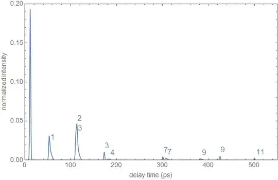

I also computed what intensity pattern would be seen at the detector, assuming a Gaussian pulse profile a couple picoseconds long and an index of refraction around 1.4:
5.033 mm
5.401 mm
Now, making the assumption that the maximum number of reflections is monotonic in the radius of the central obstruction, I used simple interval bisection to try and find the radii at which five bounces are possible. However, as can be seen in the above diagrams, exactly five bounces do not occur even with a relatively small obstruction. Indeed, we find that between 7.529 mm and 7.530 mm (close to the diameters shown in Ernie's diagram) the maximum number of bounces transitions from 3 directly to 7!

The detector profile in both cases looks like this (although without the 7-bounce peak at 7.530 mm, of course!)
I'm quite confident in my calculations; I used Mathematica's ability to deal with exact algebraic numbers, so there is no rounding or approximation, except when generating the graphics; that is why the edges of some beams don't seem to be quite tangent to the circle. I also validated the behavior of the 7-bounce beam at 7.5 mm with POV-Ray (shown below), namely that it just misses the central obstruction after the fifth bounce (instead of hitting it, as depicted in Ernie's diagram). (Note that the POV-Ray image is mirrored compared to the Mathematica images, with the vertex pointing left instead of right; and that the two large reflections come from the 2- and 3-bounce paths.)
