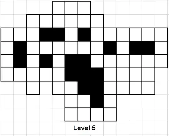

Looking up 1, 2, 6, 20, 60 on OEIS reveals that this is sequence is the total number of squares covered if you take all N-ominoes for a given N. For example, there are 5 unique tetrominoes (counting reflections/rotations as the same), and 5*4 = 20. Ditto for 12 pentominoes giving 12*5 = 60. The obvious thing to do now is split up the areas into one of each polyomino.
Here are the solutions to the first 4:
And here's the 5th:
Working out (partial)
I'm finding it very hard to succinctly show working without it turning into a case bash, so here's a partial working out. I'll try to stick to the following colour order when filling:
Let's try starting with the plus piece, since that's rotationally symmetric. There's only three places it can go since all other positions fence off chunks which aren't a multiple of 5 squares in size:
The red outline spot is easy to rule out:
By looking at places where the 5-long piece can go, here's roughly why it can't be the orange spot (click for full size):
enter image description here So the plus piece must be on the left, which also locks in an L-shaped piece further left of it.
I'd continue, but this took a very long time to draw and there's a lot more case bashing left, so I think I'll just say you get the gist of it by now :) (I'd show uniqueness but this took much longer than I thought). I might continue if I get time some day.
