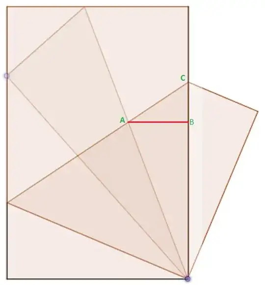

A Solution in 2 folds
Pictorial Representation of the folds
Proof
By measurement (using a ruler and folding hence not 100% accurate)
AB = ?
BC = 5.9 cms
AC = 9.7 cms
AC² -BC² = 9.7² - 5.9² = 59.28
sqrt(59.28) = 7.699 cms = 3.03 inches
Could someone help me with the maths behind this? I'm not entirely sure how to present a general mathematical solution for this.

  • wow. that is a new and interesting one – DrD Feb 21 '17 at 15:16
  • This drawing does not have 17 x 22 proportions. The angles cannot be directly copied onto a sheet of paper. – Jasper Feb 21 '17 at 17:54
  • Is the procedure? Fold the northwest corner down to the southeast corner. (AC will be along this crease.) Fold the raw edge (that used to be the top edge, and now is to the right of the original rectangle) back toward the left, along the original right edge of the rectangle. (Point A will be where the original top edge crosses the AC crease.) Fold crease AB by making a crease perpendicular to the right edge of the original rectangle that goes through point A. Unfold to taste. – Jasper Feb 21 '17 at 18:08
  • This procedure requires three folds, not two. (The third fold is needed to mark point B.) – Jasper Feb 21 '17 at 18:10
  • After using six folds to make the 11.00" x 7.333" shape of the drawing, and following the three folds of the procedure I listed in the comments, I get distances AB ~ 2.6 inches, AC ~ 3.1 inches, and BC ~ 1.7 inches. – Jasper Feb 21 '17 at 19:51
  • According to my calculations, an 11.00" tall rectangle whose height is 1.5 times its width would produce distances AB ~ 2.591 inches, AC ~ 3.113 inches, and BC ~ 1.727 inches. This is with perfect folding of infinitely thin paper. Ironically, one of the intermediate lengths (from C to the raw corner of the paper) is 5/18 of the height of the paper, or 3.055 inches. – Jasper Feb 21 '17 at 19:54
  • According to my calculations, using an 11.00" tall rectangle and perfect folding of infinitely thin paper, AB ~ 3.00 inches ± 0.05 inches when the width:height ratio is between 179:300 and 183:300. (181:300 is nearly perfect.) – Jasper Feb 21 '17 at 20:55
  • The diagram is not to scale. It's just a representation of the folds. Hence why the maths behind this is a bit weird. Representing these folds otherwise would be impossible, which is why I used a generic image.
    However on aa 11x8.5 paper, the line AB is exactly 3 inches long. We do achieve the point A in two folds, so didn't feel it is necessary to fold again to show B, since it's implicit.
    I'd be very grateful if you could verify using a paper 11x8.5 as mentioned in the question and comment your observations :)
    – Karan Atree Feb 22 '17 at 10:37
  • I very much doubt that it "would be impossible" to "represent these folds" using a correctly scaled diagram. Point B is not implicit, because there are no reference edges or creases between Point A and edge BC. My best attempt to adapt your badly scaled diagram to an 11.00" x 8.50" paper, using the three-fold procedure in the comments, produces a length of about 1.9 inches. If folded perfectly, it would be about 1.906 inches. If your procedure does not match my procedure, please explain how your procedure is different, using a correctly scaled diagram. – Jasper Feb 24 '17 at 04:59
  • Firstly, don't be a dick about it. If you can't understand my answer, ask for clarification. Being respectful in any online community is implied. As for an explanation, assume the corners of the paper are marked as 1,2,3 and 4 in a cyclic order. First take corner 1 and perfectly place it over corner 3. The first fold. Open the paper. Secondly, take corner 2, and place it on the line 1-4, in such a manner it perfectly folds the corner 3. You can understand this from the diagram I've shown. Open the paper. The point of intersection is 3 inches away from the nearest edge. Let me know how it goes. – Karan Atree Mar 02 '17 at 05:38
  • Oh and if you can suggest a tool online through which I can represent an accurate scaled diagram, I'd be very grateful. – Karan Atree Mar 02 '17 at 06:14
