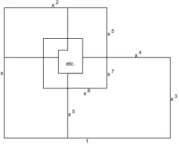

A solution with ratio $\varphi^\frac12\approx1.27201965$, where $\varphi$ is the golden ratio:
Set $x=\varphi^{-\frac12}$. Then:
The numbers work out due to how the golden ratio works. The outer numbers define the dimensions for the entire hexagon. Note that I did not come up with this polygon; it is called the Golden Bee and was originally devised by Karl Scherer in his 1987 book. This is probably optimal.
