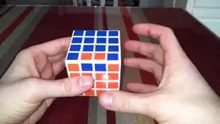

I'm a little uncertain as to why these two parity situations occur on the 4x4 Rubik's cube. The first parity case that can occur is this one, where an edge is simply flipped upside down:
The second one that can occur is this one, where two edges are swapped:
Neither of these are valid positions on a 3x3 Rubik's cube. I've been told something along the lines of "hidden pieces are out of place," but this doesn't make much sense to me. If this is a reasonable explanation, what are those virtual pieces, and why do they have to exist?
If not, what makes this a legal position on a 4x4 cube, and not a 3x3 cube?
