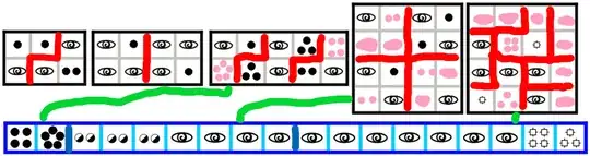

On the third rockface, a huge row of symbols glows blue beneath the puzzles.
'Ah. You want to know what the blue inscriptions mean?' He laughs wryly. 'You'll be seeing a few of those. I wouldn't worry about them now, if I were you. They're something to think about on the return journey.'

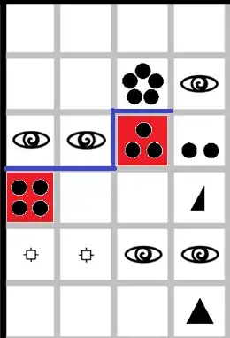

Well, that's... interesting. Now we have eyes.
Maybe I should turn around before I accidentally activate some sort of ancient curse.
No, no, I came here to get to the top, and that's exactly what I'm going to do.
I just don't want to look at the eyes too much.
Anyway, eyes look at things. (Or so I've heard.) Maybe that's somehow related to what they do?
Maybe what they "see" is important?
But how?
It can't be what they see in their own region. The third puzzle rules that out, since the eye in the middle can't see everything in its own region. (We can solve that one without even knowing what the eye does, which is nice.)
Maybe it's that...
they all have to see the same thing?
Yep, that seems to work. And it gives more unique solutions!
This also teaches us that we can't have any "dangling" walls - all walls have to be between two different regions.
So, the next set... it seems to have the eyes again, but rotated and reflected.
That just means what they "see" needs to be rotated and reflected too! This isn't so bad.
Alright, one set to go! And it has the swirly eyes. I guess those just mean...
that we don't have the direction. (But hey, at least the reflection is still given!)
Wait a minute. I was a fool.
How could I think those original puzzles were so simple? Of course the symbols meant something. No, I have to go back there with my newfound knowledge and do it right this time.

by the top right 6-pack, there are at least 7 regions, and by the bottom right, there are at least 7 dots per region. Now we can quickly eliminate the primes and the primesx2 to get 56 or 60 dots total. However 60 cannot be expressed as a times b where a, 6 are at least 7. Therefore we use exactly 56 dots.
Quote from @TheGreatEscaper:
The semi dots get used in the first logical step of realising that none of them get used
Anyways that means we have
a 7, 4 and 1, five 5s, five 2s, and three 3s.
Can we make 7 regions of 8 or 8 regions of 7 dots? 8 dots a region means that 7 goes with 1, and each five must therefore go with a 3. But there aren't enough threes! Therefore we deduce that there are exactly 8 regions of 7 dots.
We are forced to pair them like so:
(7), 5 groups of (5,2), a group of (4,3) and a (3,3,1) group. Also the (3,3,1) group must contain the very top right two 3s, and therefore the top right 2 and 5 are joined.
Okay, that was the easy part. Here's a diagram if you got lost/are not bothered to read.
Notice that I've drawn in a few edges. Also, the numbers for the filled-in regions don't matter; we know that they must be the same colour. Lastly I'm sorry if you're colour-blind, tough luck. Just read through and hopefully you get it. enter image description here

Part II.i: eyes (spooky)
This part is much harder.
Can eyes have three adjacent edges?
Seems unlikely. In fact
Looking at the top right-most region of eyes, one can deduce a contradiction (in essence, the top right most must face left, the one down must face down and therefore the top right must look like this:
which fails because the yellow going into the eye means it can't get back out, if you see what I mean.
Now question two:
Can an eye have exactly one adjacent edge?
This gets killed pretty quickly:
The top right eye cannot be part of the three dots and five dots.
Okay so we know that
eyes must have exactly two adjacent edges.
Now consider the
middle right eye
If it is not part of the green region then it has
three adjacent edges so it must be part of the green
But wait! We can deduce that the last adjacent edge must be below it. Also since it connect to green it must be distances of
2, 0 and 0 (and ???).
Now fill in the rest of the top right:
We know that an edge opposite an edge that's coloured in is NOT coloured in. Therefore the top right eye must connect to the yellow and to the six.
Can we have distances of (0,0,2,2)? No because then the other eye fails. So therefore they must be distance of (0,0,2,3)!!
Okay then finish that corner off:
Let's move on before those eyes get to us...

Partial Answer - Constellations
In the spirit of @Deusovi's answer, I will precede the actual solutions with hints. Again, two hints, with the second rot13ed.
Constellation 1
What have you been doing in all the previous sets? // Lbh bayl arrq gb havdhryl svyy va gur yvarf.
Constellation 2
Is there something missing, or is there just nothing there? // Sbe bar bs gur tevqf, lbh qba'g arrq gb svyy nal bs gur pryyf.
Constellation 3
Something else is gone. // Gur flzobyf ner va beqre bs gur tevqf va juvpu gurl ner cynprq.
It is dark, now, and as you look up into the sky, the stars begin to shine...
Hmm, those constellations look strange yet oddly familiar, and from here, even the stars of the Milky Way look like they're gathered in recognisable groups.
That first grid - you recognise it from the very first you solved on the base of the mountain. Except it's missing something. You look below it - there it is! A neatly formed dot, enclosed by a clear night sky.
C1.1
You look more closely at the band of stars below the grids.
Looks like each group of symbols has exactly the number of symbols missing from the corresponding grid!
Eagerly you begin to solve the other grids.
That second one trips you up though. Both ways of putting the symbols in lead to a unique solve.
You look again at your transparent sheet (which has proven even more useful than you thought, now that you have the stars giving you puzzles).
Of course! Only the lines matter - that's what you've been doing all along, right?
C1
As you complete the set, you look back at the stars, and realised they've shifted from before. Something looks off though.
There are only four groups of symbols. Maybe one grid doesn't need any symbols put in it?
C2
Once again, the stars have shifted. Now something looks really off.
There's one group of three symbols, but all five grids only have one empty cell?
As you think upon it, you suddenly realise,
Maybe you have to fill in the lines in the band as well?
You try that, but there are too many possibilities...
Maybe the symbols have to go into the grids in order?
C3
Satisfied, you look up again. The stars are back to normal now. Time for the journey down.
