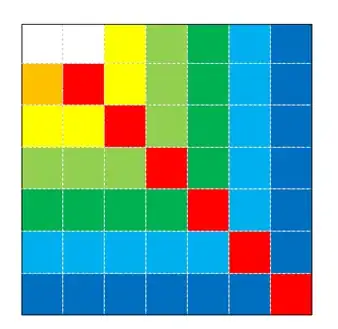

It's definitely not optimal! Here's a counterexample:
Start from the white area. Greedy algorithm would make you do all the colours on the top right (5 moves: yellow, green, dark green, blue, dark blue), then the red (1) and then all the other colours (6 moves), making a total of 12 moves.
There is an obviously more efficient method: orange, yellow, green, dark green, blue, dark blue, red, needing only 7 moves.
I don't think there's a simple algorithm to solve flood apart from a breadth first search which will bash out every possible case, since too much optimization relies on evaluating the entire grid.
EDIT: I think I should clarify what a breadth first search is, as it appears it's a programmer-centric term.
Breadth first search works through the following ways: - Only try colours that will increase your area - Store every possible state after n moves - Throw away states that are strictly inefficient - If you're a clever programmer, you can throw away some more states :).
The states stored for n = 2 are (Y,g), (Y,O), (Y,R), (O,Y), (O,R), (R,O), (R,Y).
The area (Y,O) covers is a strict subset of (O,Y) so it can be removed. (O,R) Identical to (R,O).
So we're left with (Y,g), (Y,R), (O,Y), (O,R), (R,Y).
An optional clever shortcut is to throw out (Y,R) by comparing it to (R,Y) topologically, and how any solution with Y,R can be beaten by R,Y, but that requires a lot more programming work. It'll naturally die out later down the search.
So a good breadth first search will only store (Y,g), (O,Y), (O,R), and (R,Y), for 2 move possibilities.
Basically, the first time a set of n moves turns the board into one colour, the breadth first search is done.

  • Why does the greedy algorithm force you to begin with yellow? It looks to me as if it would equally well choose orange, in which case everything goes nicely. (But if we just duplicate your example's first row, we get an example where the greedy algorithm does force you to begin with yellow.) – Gareth McCaughan Dec 14 '16 at 15:04
    @GarethMcCaughan You gain two squares of area with yellow, one square with orange. Additionally, if an algorithm has decisions where they can 'equally well choose' different options, which might not actually lead to an optimal solution, it can hardly be called optimal anyways. – TheGreatEscaper Dec 14 '16 at 15:47
  • oh, sorry, I'm a twit. I was thinking the greedy algorithm was picking whatever colour has most cells immediately adjacent to the top-left region, which is of course complete nonense. My apologies. – Gareth McCaughan Dec 14 '16 at 15:53
