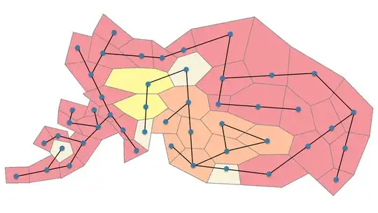

The first thing you need is the elephant-rhino painting. Solving this will give you the key to with which to decrypt the ciphertext later. The painting consists of 48 tiles. Rotating this picture 180 degrees makes clear that we're actually looking at a, slightly distorted, map of the USA. Only the not connected states Alaska and Hawaii are missing out. Next, it's important to look at the coloring: only the gray states matter. Using the map Carl Löndahl created, one can see that all the states in between each pair of gray states are all colored the same. Starting in Massachusetts, going through North Dakota and Arkansas to Indiana, all states between Massachusetts and North Dakota are colored red, all states between North Dakota and Arkansas orange and both states between Arkansas and Indiana yellow, whichever route is taken. This also means there's only two possible ways of travelling through all of the gray states. Using the state abbreviations we find:
MA (Massachusetts), ND (North Dakota), AR (Arkansas), IN (Indiana), MA-ND-AR-IN, which is the language, the vigenere key.

The elephant/rhino is a 180 degrees rotated, slightly distorted map of the USA, with all the correct state borders. I don't know what to do with that yet, though. No idea why some midwest states are colored differently. There must also be something special going on with Kentucky/Tennessee...
I'm guessing the solution to the first part will be a set of directions which will somehow lead you to the correct state, through the little gaps in the borders.

This is not an answer, but some observations...
The map contains some missing parts in their borders (as hinted in the OP), which may indicate that you are able to travel between them (or that they actually are adjacent).
I created the image below, which indicates the...
...connections (or non-connections between the countries) enter image description here I tried to find a set of countries which satisfy the graph, but I haven't found any yet.

...try to overlay the lines in the map, maybe. I haven't figured out how it would make sense, though. Maybe the element names map to country names or something.
