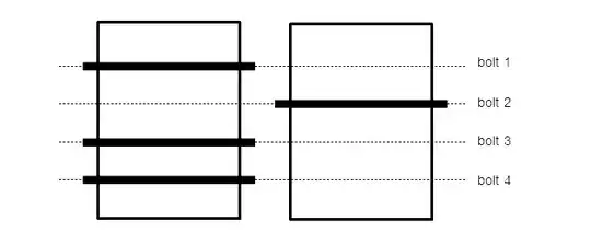

You are in a room with two adjacent doors locked by four sliding bolts. The bolts are movable and block only one door at a time; however, you do not know which bolt currently is blocking which door.
An example configuration:
two doors blocked by four sliding bolts (example configuration)
Luckily, there are three buttons A, B, C, which cause some bolts to slide from the door they are curently blocking over to the other door. However, each button can trigger different actions, which one is used is determined at each push in a fully random way:

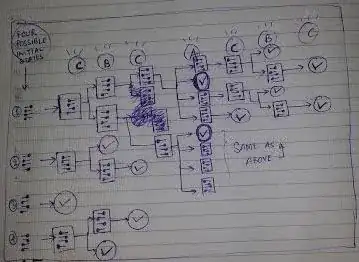

I know it's a year old question, and has already been solved, still I gave it a swing. I see the other answers have used transition matrix, which I have no idea what that is. I solved it in kind of a different way. Maybe in principle does the same, but what the heck, I spent hours on it, and I want to share it! Sorry if the image is too messy, but I hope it manages to get the idea across.
It's kind of messy, but I guess you'll get how I reached the solution using the flowchart thing.
So at each step I basically chose the button that had the best chance to arrange the bolts in a way that the door is able to open. For example, out of the four initial states, pressing "C" would open the door if it was state no. 3, for sure. Pressing "A" could open if it was state no.1 but not for sure. Pressing "B" could open if it was state no. 2 or 4, but again, not for sure. This way I was able to eliminate the case of initial state 3. Similarly I chose the buttons at each step in a way that would eliminate most of the possibilities. (I hope I'm making sense, if not please discuss if interested.).
This way the solution came out to be, as stated by other answers,
C>B>C>A>C>B>C
(check the door after each step.)
