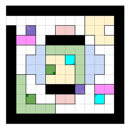

The Memory Amnesia Labyrinth Rules
  • You are currently just behind the door in the bottom right top left.
  • You must walk through each of the other rooms before returning to the first room. Steps must be to horizontally or vertically adjacent tiles - no diagonal movement.
  • You may not step on the same tile twice.
  • You must step on every tile in a region.
  • Every time you step between two tiles, a line will be drawn between those two tiles' centers. This means that the line will trace out your path along the tiles, moving like a rook in chess.
  • The most important rule: When your path is completed, every region of the same color and shape must look identical. (If you enter two blue rectangles from the bottom left going up, your paths through them must be exactly the same. You can trace them out in reverse, but the lines left behind must be identical.)
  • Each region has a counterpart that looks the same, but has been turned upside-down.
  • The most important rule: When your path is completed, if you turned in one square, you must go straight through its counterpart, and vice versa. (For instance, you will have to turn in the top right square; this means that you will go straight through the bottom left square of the middle yellow region.)

(For the color-blind, I have marked all groups of 1×1 squares with symbols.)

A possible path :
Proof that it works : (S means straight and T means turn )
I don't really know how I've find it, mostly trying some random paths + an incredible luck.
Here is a smart move to start because it forces a lot of other moves
