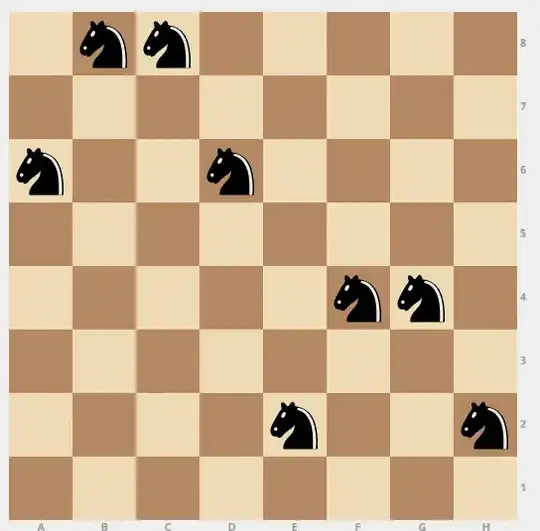

I can do it in 8:
And of course, this is the optimum, since each knight attacks 8 squares and we need to cover at least 64.

  • Kudos, by the way found a general solution that every NxN chess-board in form of a Torus can be dominated with N Knights... was proving my hypothesis O:) – ABcDexter Jul 17 '16 at 13:02
    @ABcDexter: Can you show a proof? That's really interesting. – Deusovi Jul 17 '16 at 13:03
  • Ok, but you have to wait as my buggy program is showing it for N upto 8, i seriously need to check it for higher values of N. (can't follow hypothesis solely based on a code and intuition) – ABcDexter Jul 17 '16 at 13:09
  • And I think i am wrong, which would make me sad :/ but again, Truth(and Logic) alone triumphs... – ABcDexter Jul 17 '16 at 13:11
    You need at least ceil(N²/8) knights for an NxN board, which is bigger than N if N > 8. The way this arrangement happens to cover every square is very fascinating, I must add. – ffao Jul 17 '16 at 15:51
  • This is just one example of a family of 256 arrangements each having two sets of four knights placed on alternate squares of two "diagonals" of opposite colour. – Neil Jul 17 '16 at 23:25
  • @ffao Yes precisely, this is why I was wrong in that first statement of mine. I am still skeptical that it would work for N up to 8. – ABcDexter Jul 18 '16 at 06:20
