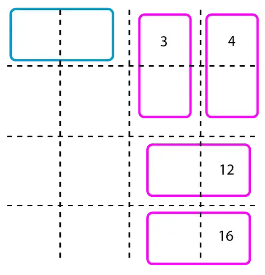

In any rectangle with a side length $l$ of 2, you can't have any domino aligned so that its long side is aligned with $l$ because that would provide an immediate cut point. The only other option is to have the long side of all dominoes 90° compared to $l$, which provides cut points after each stacked pair. (Or if you try to offset the pairs, leads to an unfillable gap of 1x1 at the ends.)

A 3 x 4 rectangle has one end (let's make it the top) of length three, and thus must begin like this:
But whichever way we try to fill the second position in the second row (horizontal or vertical) we end up with a cut site.
3 x anything
A side length of 3 will never work. Based on the second picture above (3x4), you must always start the top the same way, and then must always alternate magenta dominoes down the side. If it's an even number (3x6, 3x8, ...) you'll end up with a cut site like the one shown in the 3x4 diagram, on the second vertical. If it's an odd number, you'll end up with an unfillable 1x1 square at the bottom right.
