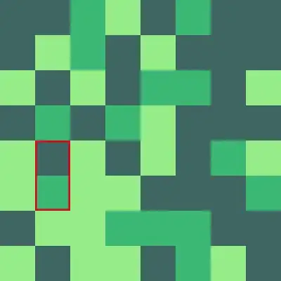

I've created a new puzzle from an Alexey Nigin's idea. It consists of a 8x8 board where each square is randomly assigned one of three colors. A movement is defined by picking any two orthogonal adjacent squares (forming a domino shape) with different color. Then they both turn to the third color. The objective is to reach a board with only one color.
An example picking two adjacent squares (domino shape).
You can play a test version here.
For each initial board state, there are three final possible states (one of each color), but only one can be achieved.
The question is: Is one final color always achievable?
It would be also interesting to know the hardest configuration (or one of them) and how many steps are required to solve it.
