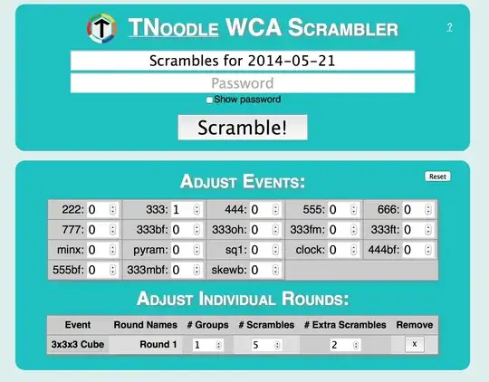

If you're willing to take the time: The World Cube Association has a specific method for shuffling their cubes. They use a program called TNoodle to do the scrambling; the program generates a "scramble sequence" which can be followed to produce a scrambled cube.
Their code actually features a nice interface to generate the scrambles:
I have yet to figure out what the "Adjust Events" options do, but producing the scramble sequences just comes down to clicking the "Scramble!" button.

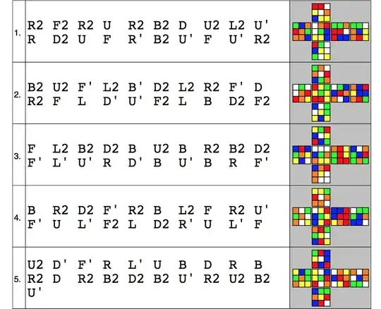

Here's the result of running their program:
There is also an online interface here. I used it to scramble my new 30x30x30 Rubik's cube:

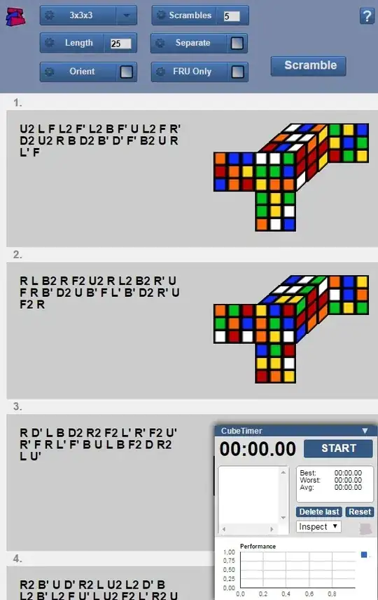

The best tool to generate scrambles for all WCA puzzles is http://ruwix.com/puzzle-scramble-generator/
It supports cubes from 2x2x2 up to 11x11x11, Square-1, Rubik's Clock, Megaminx, Pyraminx and Skewb. You can customize the scramble in many ways and there's a built-in stopwatch to measure your times.
