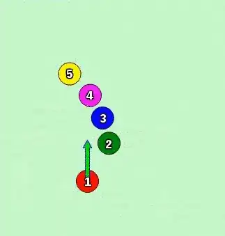

EDIT: A rough demonstration of what happens in the upper part (with a very large curvature), made using this program:
