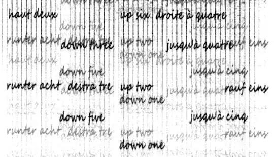

Decoding the track from Deusovi's answer using by calculating its "spectrogram". For people who know about signal analysis, it is basically using the Fourier transform of each of many finite pieces of the signal, then putting all those results in a stack. This gives a spectrogram, and when plotted with a color scale, it gives the posted result.
left 3 in german; right 4 in german; left 3 in italian; up 7 in german
right 4 in english; left 1 in german; left 5 in italian; left 6 in french; right four in english
EDIT: Actually forgot to analyze the other of the two stereo tracks:
Mixing the two:
UP 2 RIGHT 4 UP 6 RIGHT 4 UP 7 2
LEFT 3 DOWN 3 LEFT 3 UP 4 RIGHT 4
DOWN 8 RIGHT 3 UP 2 LEFT 6 UP 1
RIGHT 4 DOWN 5 LEFT 5 UP 5
LEFT 1 DOWN 1
Tracing this on the dotted graph:
There is only one way as it touches all borders.
