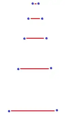

The maximum value of dead bandits clearly is $10$ (so that all are dead).
For instance, put five bandits
at the points $(100,0)$, $(200,0)$, $(400,0)$, $(800,0)$, $(1600,0)$ and
five bandits at the points $(100,1)$, $(200,2)$, $(400,4)$, $(800,8)$, $(1600,16)$. Then no pair is the same distance apart, and the five pairs
with equal $x$-coordinates kill each other.
