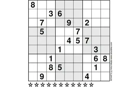

Solve this Sudoku. Post how you did it in your answer. Enjoy!
8..........36......7..9.2...5...7.......457.....1...3...1....68..85...1..9....4..
Note: I put this program into the solver on sudokuwiki.org and it couldn't find any numbers. I then gave it cell H7 (the only cell with two possibilities) and still no luck. Then I gave it cell G7 (which became the only cell with two possibilities) and it was only able to solve one cell before it got stuck.

For this puzzle, while it has one and only one solution, no known patterns work on it, other than a slightly more intelligent guess-and-check. The number of steps one has to look ahead in order to reduce away clues is the metric here, and this puzzle needs nine sequential guesses to reach a solvable state.
The solver on SudokuWiki can't get it because it would simply take too long to do in Javascript, and it's not programmed to guess numbers.
The solution requires one to assume the values of squares, and then reduce the puzzle to see if you need more assumptions - if you do, make another one and continue. It is a depth-first-search of the possible solutions, in essence. The solver on sudoku-solutions does come up with the solution to this puzzle, but when asked to provide the steps, declares:
This solver could not solve the puzzle completely by logic, this does not mean there is not a logical solution.
and then promptly fails to list any of the steps it used to solve it. This only happens when the solver must use brute-force branching guessing to find the solution.
As a result, there is no way I myself could reasonably provide a "how to solve this puzzle" answer, since doing so would involve finding these specific chains and explaining why the other vast quantity of chains don't work.
But that's how you do it: assume a square is a number, then another, then another, and keep checking until you've come to a sequence that still makes sense and allows you to solve the puzzle, or you've come to a contradiction and need to back up and try again. I'm afraid I think this is the best answer you can get to this question.
Since you did ask for a solution to the puzzle, however, I can provide it (mouseover the spoiler block):

Download the prime minister of Singapore's Sudoku solver and feed it this puzzle (ONLY if you're REALLY stuck). Believe it or not, that prime minister made a pretty robust program, and although it looks like it gets stuck for a while there, it eventually comes out with the following solution:
862 || 751 || 349
943 || 628 || 157
571 || 493 || 286
159 || 387 || 624
386 || 245 || 791
724 || 169 || 835
217 || 934 || 568
438 || 576 || 912
695 || 812 || 473
