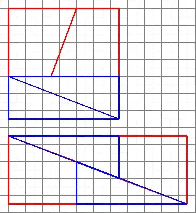

Here is a interesting picture with two arrangements of four shapes.
pic
How can they make a different area with the same shapes?

This is a famous physical puzzle that can be tied to the fibonacci series.
To answer the question as posed, the issue is that the two slopes are different ($\frac25$ vs $\frac38$). Note that all those numbers are in the fibonacci series ($1,1,2,3,5,8,13,21,\ldots$).
Successive fractions are closer approximations to $\varphi$, alternating between above and below. Diagrams like this can be generated by making a square with sides equal to a number in the fibonacci series (in this question 8), then dividing it into two rectangles with widths of the two fibonacci numbers that make up the first one chosen (3 and 5).
Cut the smaller one down the diagonal, and cut the bigger one down the middle at a diagonal, such that the width of the diagonal cut is the next smallest number (2 in this case). Note that this will leave a trapezoid, whose small parallel size matches the original small rectangle's smaller side (3 in this case), and whose larger parallel size matches the original larger rectangle's smaller side (5 in this case).
Since $\frac25\approx\frac38$, and from the above constructions, the pieces can be rearranged into a rectangle (as shown), the area of which will always be one away from the original square, but will look approximately correct, since the slopes almost match.

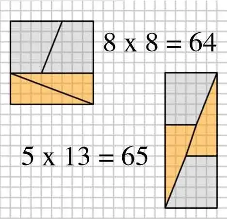

Edit: Since this answer received so many up-votes (thank you!), I suppose people are very interested in it, so I thought I'd draw up a few images!
1,1,2,3: $3\times3 = 9 = 10 = 2\times5$
1,1,2,3
1,2,3,5: $5\times5 = 25 = 24 = 3\times8$
1,2,3,5
2,3,5,8: $8\times8 = 64 = 65 = 5\times13$ (The OP's example)
2,3,5,8
3,5,8,13: $13\times13 = 169 = 168 = 8\times21$
3,5,8,13
5,8,13,21: $21\times21 = 441 = 442 = 13\times34$
5,8,13,21

153
The diagram is misleading, as it hides a gap in the middle of the second configuration.
This is what we actually get if we rearrange the shapes in question. Notice that the diagonal “bows” slightly, leaving some extra space between the shapes – this is where the extra unit of area creeps in.
But you shouldn’t trust me any more than the person who drew the original picture!
As we see here, pictures can be misleading – so my diagram isn’t proof that the original diagram was wrong. This just gives an intuitive sense of where the extra space has come from.
For a proper proof, consider the gradients:
  • The gradient of the blue trapezium is $5/2 = 2.5$
  • The gradient of the red triangle is $8/3 = 2.666...$
Since the gradients don’t match, we can’t arrange them side-by-side like this without some blank space between them. But because they’re close, the eye can be tricked into thinking they form a single continuous line, and doesn’t notice the slope on the triangle changing midway down.

14
The image on the right cheats: the pieces don't actually fit together perfectly, there's a gap in between. To prove it, we can calculate the size of the gap, by calculating the size of a triangle, formed by:
  • the longest side of the yellow triangle: $a = \sqrt{3^2+8^2}$
  • the inclined side of the trapezoid: $b = \sqrt{2^2+5^2}$
  • the diagonal of the rectangle on the right: $c = \sqrt{5^2+13^2}$
The area of this triangle can be calculated using Heron's formula:
$$ A = \sqrt{s(s-a)(s-b)(s-c)} $$
where
$$ s = \frac{1}{2}(a+b+c) $$
Substituting the values into the formula gives exactly 0.5 for $A$. There are two such triangles, so that's a total 1 = the expected discrepancy.

It's a misleading diagram. In reality, the angles do not match up- the larger interior angle of the orange triangle is about 69.5 degrees, whereas it's 68.2 for the grey quadrilateral. (Correct me if I'm wrong- dusting off my trig here.) In the diagram with area 65, the orange areas are actually quadrilaterals. If you look closely, you can see that they have a slight inflection where they meet the other orange section. So that extra area comes from expanding them just a bit.
Patrick N
  • 1,790
The triangles don't have the same slope; you can see that the large diagonal line through the "larger" rectangle bends. It's covered up by the thick lines around the triangles, but there is a very thin hole that has a total area of one square - the same square that supposedly "appeared out of nowhere".

Simple answer:
Those shapes (in orange) at the right side of picture, are not triangles at all! they are two quadrilaterals. an thus they have area greater than visually expected. so there is no equity here. They are different and thus have different total area.
WordPress Speed
  • 163
The picture of the bottom rectangle is misleading, because it fools people into incorrectly assuming the width of the triangles to be exactly 3 units.
The real width can be easily calculated - it's a fraction of the total width, defined by the height of the point on the diagonal, or at exactly 8/13th of 5, ie. 3.076923077 (and not 3), q.e.d.
emzet
    According to the puzzle statement, the triangles in both diagrams are identical, and the shape of the triangles is defined in the 8x8 configuration to be exactly three units by eight units. The error is well illustrated in alexwlchan's answer, and mathematically explained in several others: The pieces don't actually fit together in the 5x13 configuration. There's a thin trapezoidal gap between them, which is hidden by the thick, black, and not-quite-straight diagonal line drawn in the original 5x13 illustration. – Solomon Slow Dec 30 '15 at 16:40
