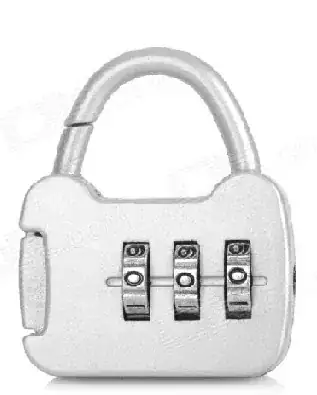

In a simple combination lock, a sequence of several digits is used as a password, with one wheel per digit. Generally, it is not possible to unlock the lock without knowing the password, but due to the workings of this lock's mechanism, a "click" is heard whenever a wheel is rotated into the correct position.
For example, the following lock has 3 wheels, each with the digits from 0 to 9. Trying all possible combinations would require up to 1000 attempts to unlock the lock. But due to the clicking mechanism, it is possible to so in at most 30 tries (up to 10 tries for each wheel, where a "try" refers to a single rotation of a wheel).
Now, instead of 10 digits, you can design the lock to have $k$ digits on each wheel ($k \in \mathbb{N},\ k\geq 2$). For security reasons, we want the lock to have at least $N=10^{10}$ different possible combinations. The lock can have as many wheels as needed.
  1. What is the optimal value of $k$ to minimize the number of tries (wheel rotations) needed to open the lock in the worst case? What about the average case?
  2. Now, suppose that the lock can have different numbers of digits at different places. For example: The first wheel can hold 7 values (0 to 6), the second can hold 4 values and so on. Again, how can we minimize the number of tries in the average and worst cases?
Can you generalize for any $N$?

  • Are the only three possible results from testing the lock "nothing," "click," and "open?" Or do we get some information about how many wheels are in the correct position? Also, is the lock guaranteed to be in a non-clicking position at the start or are the wheels randomly positioned initially? – 2012rcampion Aug 22 '15 at 23:03
  • Yes, "nothing", "click" and "open". You may have to turn the whole wheel to find a click. The lock is in a random position. – Rohcana Aug 22 '15 at 23:04
    I remember finding a lock like that in my basement one day. And yes, I went through the 999 attempts way. I eventually found it around 600ish – warspyking Aug 22 '15 at 23:13
  • Does your 30 tries worst case take into account the cases when you start in a position that clicks? Also, shouldn't it be 9 tries per digit (since if 0-8 haven't clicked, 9 is guaranteed to be correct)? – 2012rcampion Aug 23 '15 at 01:25
  • @2012rcampion Remember that, even if we know 9 is the correct answer, we still have turn the wheel to make it 9, otherwise we won't be able to unlock the lock. In other words, our aim is to unlock the lock, not find the key. – Rohcana Aug 23 '15 at 01:28
  • But we still wouldn't have to use a try: the worst-case would be 3 for setup (worst-case to clear the lock if we start on a 'click'), 9 for each digit, and 1 to unlock. This brings up another point though, if you did turn the first digit to 9 (knowing that 9 is the correct answer), wouldn't every subsequent try on the second and third digits result in a click, regardless of whether they are correct or not? Or do we get separate clicks from each digit? – 2012rcampion Aug 23 '15 at 01:34
  • @2012rcampion A click may only result if you are changing a digit. And we do count the unlock step as a try, I suppose OP isn't clear in this point, so i will have to edit it. – Rohcana Aug 23 '15 at 01:38
  • So let me see if I understand you correctly: a dial may be rotated from one digit to an adjacent digit, which counts as a 'try' and may result in a click if that dial was rotated to the correct digit for that dial only? When I saw the word 'try' I assumed that you rotated the dials to some position and then attempted to open the lock (e.g. by pulling on the shackle), which would result in a click if one or more of the dials were on the correct digits (I actually have a luggage lock that works this way). – 2012rcampion Aug 23 '15 at 02:09
