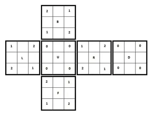

To define the invariant, label each of the corner cubie stickers in the solved state with a number 0, 1, or 2, according to this diagram of a net of the cube:
Define $\varphi(\Sigma)$ to be the total number on the stickers on the up and down faces mod 3 in the state $\Sigma$. This of course gives a (surjective) map from the full cube group to the group $\mathbb Z/3\mathbb Z$, which is not clearly a homomorphism. I won't give a full proof that it is, but I'll take you most of the way there.
You may wonder where this particular choice comes from. In fact, the only reason I chose it is because it makes it very easy to see that $\varphi(a_i) = 0$ for each generator $a_i$. For the up and down moves, these don't even change any of the numbers at all. For the other 4 moves, the numbers do change, but they change the same way for all 4. Hence, you only need to check one position, and it's easy to check $\varphi(F) = 0$. For the proof I give below, it's a bit more convenient to check that the inverses of the generators also preserve $\varphi$, which only requires checking one more state $\varphi(F')=0$.
