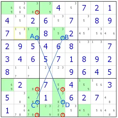

I've highlighted the X-Wing and the 9's involved in this X-Wing:
See how's there's two 9's in row 3 and also two 9's in row 8? (highlighted in blue)
Since every row must contain exactly one 9, either A and D must both be 9 OR B and C must both be 9.
In either case, these 4 squares will provide the 9's for rows 3 and 8, and because of that, they will also provide the 9's for their columns (3 and 5).
This means that any other squares in the same column as these squares can NOT be 9. So any 9's in these squares can be deleted. (highlighted in red)
Try making any of the red ones a 9, for instance row 1, column 3. If this were a 9, then A and C cannot be 9. But then, for rows 3 and 8 to both contain a 9, Both B and D would have to be 9 and this is not possible, because then column 5 would have two 9's.

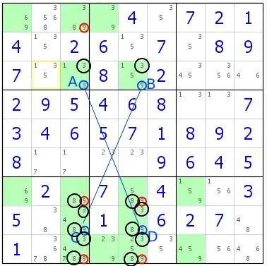

I am rehashing this question because I was going through some historical puzzling.se and it was poorly answered and understood before. The issue is not only in the 'x-wing' shown before, but also in the three lowest boxes (7-9) in the shown columns 3 and 5.
The trick is that two different numbers are possible in each box involved in the x-wing (not just one, as the previous answer supposed - then, it may still become the only possible number, which is a crucial solving technique in sudoku). So in either of the cases where the combos are 3&9 or 8&9 in the boxes, the x-wing forms (think about it - an x is made up of two lines) and the puzzles become unsolvable.
I have circled some of the other numbers involved in the x-wing predicament in the following image.
I recognize that this post is more complicated than the previous answer, but it is important to note that when identifying x-wings more than one number must be involved in order for it to actually be a standstill/unsolvable situation
Notice also that each of the locations highlighted in the original answer are in separate 3x3 boxes and may be solvable within those boxes.
Quite simply, I have yet to find an easy way of spotting an x-wing without simply identifying four squares in a rectangular pattern and at most two 3x3 boxes that each have the same 2 possible numbers.
If this post needs further clarification please let me know.
