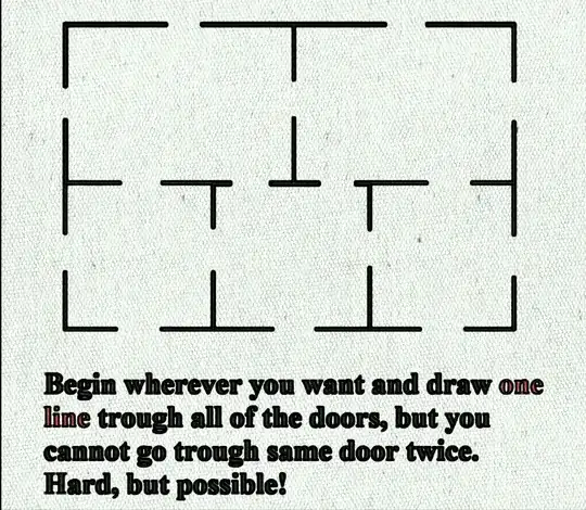

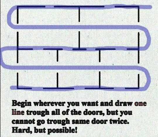

I saw the following problem on 4chan and couldn't solve it:
It's very likely to be some kind of troll (no solution).
I'm hoping to see some rigorous proofs that disprove the existence of such a line.

It works when you use a really wide line:
Philipp
  • 1,310
42
It is impossible.
Quite the same problem is "Seven Bridges of Königsberg", it was solved (proven) by Euler.
  1. Suppose you have drawn such a line and follow it from one room to another. Since you must use each door you must have a look at each room out of 5. What are these rooms?
  2. There will be 3 (at least) rooms you always go through - if you enter it you always exit it later.
    Indeed, 1 (at most) room you can start at, and another 1 (at most) room you can finish at, but others you must go through: $5-1-1 = 3$.
  3. Since you use each door exactly once, the mentioned 3 rooms must have an even number of doors, since you entry them the same number of times you exit them. But you have only 2 rooms with an even number of doors, the others have 5 doors. So you could not draw such a line.

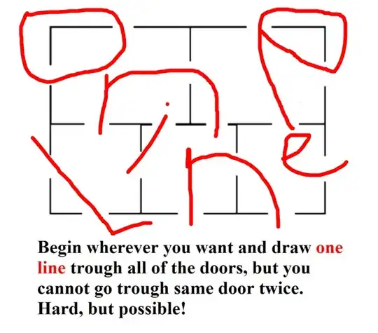

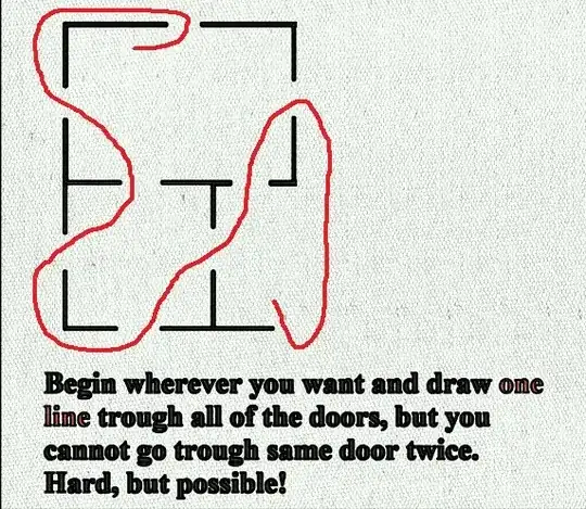

Just for fun:
Actually, there is solution, which formally satisfies all the rules. You just need to walk through a wall!
Hard, but possible! enter image description here
klm123
  • 16,216
  • 64
  • 125
    +1. I think this is the troll solution envisioned by the poster in 4chan, because it satisfies the rules! Nobody says you can't walk through a wall. Hard, but possible! Haha – justhalf Jul 04 '14 at 02:49
  • HA!, draw a ine through one wall. – Jasen Mar 29 '18 at 09:55

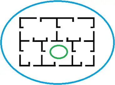

Similar to klm's solution, this one requires a little bit of lateral thinking but doesn't actually involve walking through a wall. Instead, you have to fold the corner of the piece of paper that the picture is drawn on, to form a bridge over a wall.

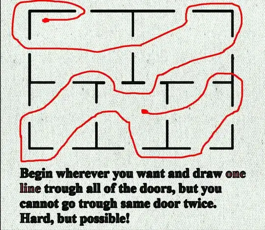

You can draw a graph with six vertices, one for each room and one for the outside. Draw an edge to represent each door. The puzzle asks for an Eulerian path, which can be done if no more than two vertices have an odd number of edges coming in. In this graph the top two rooms, the middle bottom room, and the outside all have an odd number of edges coming in, so in the usual way there is no such path. A sketch is below. ABCDE are the rooms in the same locations as in the picture, F is outside, and the lines are connections through doors. ABD and F all have an odd number of edges coming in.

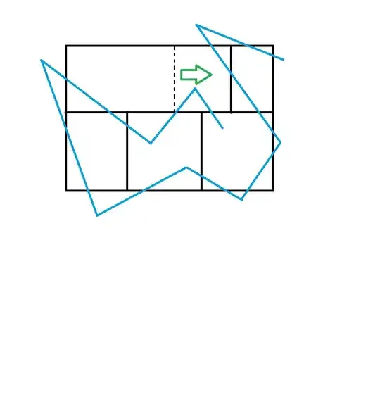

Alternatively, going "through" a door need not necessarily be interpreted in the same way as one would in a house.
This single, continuous line passes exactly once through each door, which is the constraint in the original question. Of course, it also conveniently side-steps making any other assumptions and takes certain liberties with the walls.

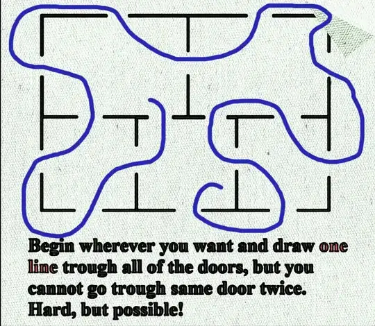

If we take this puzzle in the spirit in which it was originally created, and not quibble about whether openings are windows or doors, and if we acknowledge that this house represents a house that we could walk from room to room only through the given doors, then, as presented, there is no answer.
IMAGINE, if you will, that this is a life-sized house.
Five-Room House starts with all 16 doors open
When you start, every door is standing open.
  1. Start anywhere and go through each door, but as you go through, close the door behind you so that it becomes a wall.
  2. You cannot walk through a wall.
  3. The only way to solve this puzzle is by cheating.
Euler proved that when a vertex (a room in this example) has an odd number of lines (or in this example, a room that has an odd number of open doors leading out of that room) coming from that point, the answer must either start or end on that vertex.
When we have zero odd vertexes, you can start anywhere and you will find an answer that ends back in the room you started in that will have gone through every door.
When we have two odd vertexes (vertices), the path MUST start in one and end in the other.
When we have four odd vertices, there will be two "odd vertices" that have one unused line, one unused door between them, and no way to get to either of those rooms.

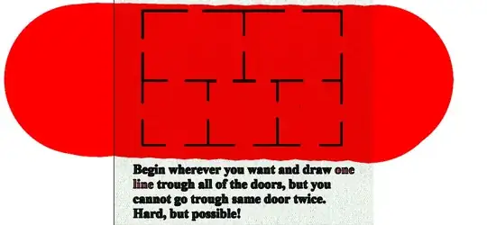

HOW TO CHEAT:
  1. Fold a corner over so that the corner of the diagram is suddenly covered by the blank other side of the paper.
  2. Build your house over a basement. Put a square hole in the floor of the kitchen (one of the five-door rooms, then put a "Wizard of Oz" exit from the basement leading to the outside. (The doors flat in the ground that you lift out of the way to climb up from under the house after a tornado.)
  3. Draw the diagram on a skewed (not evenly baked) bagel, with the bagel hole in the middle of the middle room in the bottom (a room with five doors). Topologically, the outside of the diagram and the inside of the room are now one. You can draw one continuous line starting in the top left room, eventually when you enter that "hole" room the third time, continue that line down through the hole and around to the outside of the house, then go back in the house by one of the other unused. Eventually, you will only have one door left, which will lead you into the top right room.
Five Room House Puzzle drawn on a bagel
Of these three cheats, the bagel is my favorite, but if you use permanent ink marker, I would recommend you don't eat the bagel after math class.

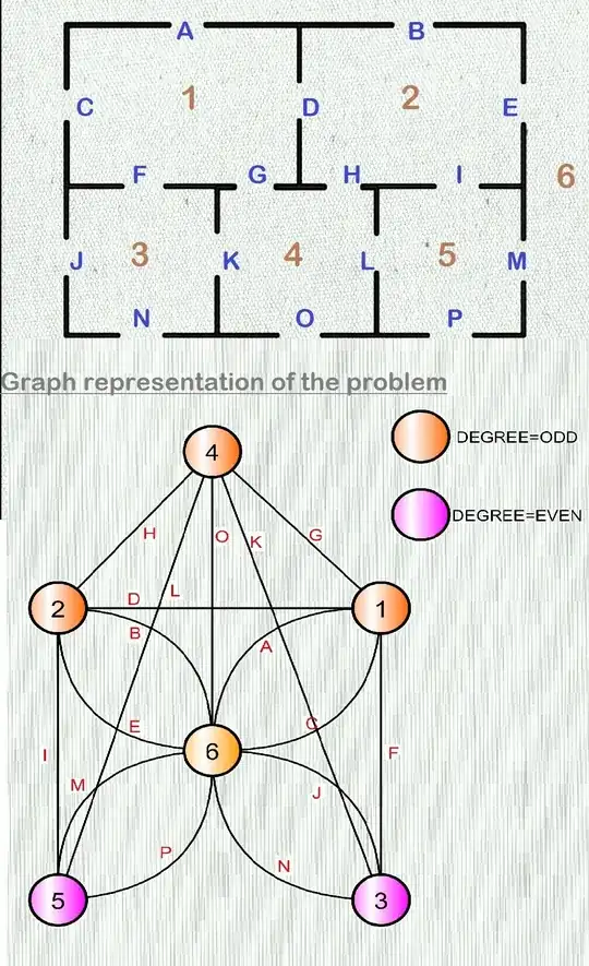

graph representation of problem

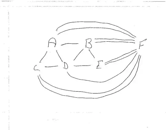

According to graph theory
Given a graph G, is it possible to find a walk that traverses each line exactly once, goes through ail points, and ends at the starting point? A graph for which this is possible is called eulerian graph.
Thus, an eulerian graph has an eulerian trail, a closed trail containing all points and lines.
  Theorem: The following statements are equivalent for a connected graph G:
    (1) G is eulerian.
    (2) Every point of G has even degree.
In this problem there exists 4 points(nodes) with odd degree. So this is not eulerian graph.
i.e: There no solution existing.

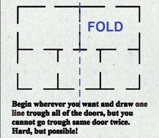

You guys have to think out-side the box (or in this case the 2D screen). If this was on paper we can fold the paper and solve the problem, as shown below. Unless there is a change to the original configuration of doors and walls, this problem is impossible. Hence the warning of "Hard, but possible!"
Fold Paper Solution
  • But ... that doesn't actually go through all the doors, does it? How is this "solution" any different from arbitrarily deciding it's ok to take scissors to the paper and cut off the right half entirely, as you've effectively folded it out of the puzzle? – Rubio Mar 23 '18 at 12:28

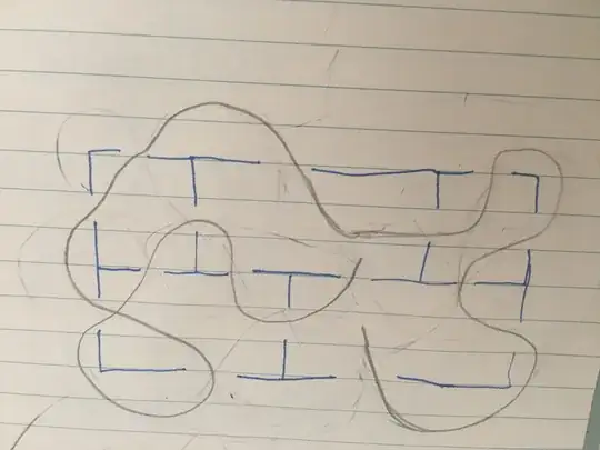

It took me quite a while to do but I worked it out
  • Your floorplan is not the same as the one in the question. – Gareth McCaughan Feb 19 '19 at 13:49
  • No I just took the picture the wrong way up. If you turn it upside down it will look right. I could delete this post and then take another picture the right way up ‍♀️ – PuzzleMaster Feb 19 '19 at 13:52
    Oops, sorry, I was confused by the upside-down-ness. But what definitely is wrong is that you have used one door twice (near the bottom left in your version of the picture), which you're explicitly forbidden to do. – Gareth McCaughan Feb 19 '19 at 13:52
  • Oh ok thanks for telling me I’m going to try again now lol – PuzzleMaster Feb 19 '19 at 13:55
