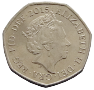

Out-of-the-box solutions using just the coin, mostly coin-rolling and not coin-flipping:
  1. You never said the coin was round. It could be a heptagon or Reuleaux (constant-width, hence easily rollable) heptagon, just like the British (or pre-Euro Irish) 50p coin or British 20p coin. (If it isn't, you could clip it into that, although that seems contrived.) Label the sides 1..7 clockwise starting from some recognizable point on the head or tail. Roll it.
    • NOTES: a Reuleaux polygon coin is both perfectly unbiased and rollable, unlike other approaches. Naively clipping the edges off a round coin would create something that was both biased and unrollable. And this actually cites the construction algorithm, it doesn't just conjecture that such a thing might be feasible.
    • you can read the result off a (labelled) polygonal coin near-instantly, unlike a round coin with a polygonal motif.
  2. Roll the coin around a circular track, like a roulette marble, which again has been predivided into seven (or 14, 28 etc.) equal sectors (or you could flip it in the air just to see where it lands and disregard the face it lands on, but the flipping movement is unlikely to be unbiased wrt where it lands).

British 50p coin British 50p coin
Old Irish 50p coin (pre-Euro, last used in 2001) enter image description here
UPDATE: some lists of polygon coins of the world 1) BezalelCoins 2) CoinBrothers

    @bobble: No it's not: a) the point of a reuleaux heptagon is the sides are self-numbering. Can read it instantly. b) I hadn't even seen that answer, and its answer is buried in the sixth pargraph under tons of offtopic chatter. – smci Jan 29 '21 at 21:12
  • Your a) I'm confused by but if you say it's different, then fine. For b) - please read the other answers before answering an old question, to make sure that your answer is original or adds value in some other way. – bobble Jan 29 '21 at 21:14
  • No I'm not 'confused'. There are coins that have seven faces. And moreover they are constructed in such a way (constant-width) to be easily rollable. I didn't just point out that was possible, I showed a real-world case. My answer is original and does add value, please stop talking down to me. I always skim the answers. First, methods 2 and 3 I mention are unique. Second, it's not my fault if a way overly chatty answer finally mentions the thing buried in its paragraphs. (I only now notice commenters from 2016 had mentioned the UK 20p - but that's not in the answer; they could have posted it) – smci Jan 29 '21 at 21:24
  • The details of how a Reuleaux polygon is constructed to be constant-width, and thus easily rollable, are not trivial, and at first glance counterintuitive. This in itself is also noteworthy. Noone else posted that either. – smci Jan 29 '21 at 21:26
