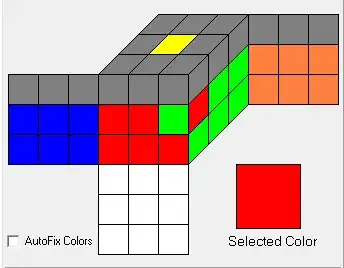

If you use the Beginners' Method to solve the Rubik's cube, and solve the equator layer (the layer between the U-layer and D-layer), it can happen that one of the edges is flipped, like this:
Flipped edge in Equator layer
Screenshot generated using Cube Explorer
A way to solve this is to replace the flipped edge by a random block and then put the edge at its right place. However, I would prefer a shorter way to do this. It does not matter what happens to the top layer.
How can I do this?

An intuitive solution is to remove both the corner and edge, splitting them up, then move them back in an intelligent way. This can be done with:
R U R' U' R U' R'
then by solving again.
Or, you could just memorize an algorithm. A couple easy solutions:
(R2 U2) (F R2 F') (U2 R' U R')
(R' F R F') (R U' R' U) (R U' R' U2) (R U' R')
It's also a good idea to actively avoid being stuck in this situation whenever possible.
Just face the cube as your image and do the following....
R U R' U U R U U R' U F' U' F

With your orientation:
R Ui Ri U R Ui Ri U R U U Ri Fi U U F
Breaking it down:
If you watch the piece this takes the two of them, splits them rotates them, and aligns them reorientated on the top layer.
U U Ri Fi U U F
This takes the two pieces, rotates them to the back, pulls the right side back in place, flips the front for the two pieces, and then rotates them in and flips it down.
Q.E.D.

I would suggest starting to look ahead (which you might do earlier than this, but could do here), you know you will want all the top (as you show) edges to have the correct flip, this would be an ideal point at which to start combining your efforts - your method most likely does the corners next, but it is most likely that the manoeuvres you already use do not flip the edges*.
The fact that this edge is flipped and $7$ are not (the ones you've solved) means either $1$ or $3$ of the other $4$ (on the top) are flipped.
If only $1$ edge is flipped on U ($3$ yellows are facing up in your diagram) you could use a "flavour" of a single $9$ face-turn manoeuvre to both flip the edge you are solving and that one:
Flipped U Edge    Sequence
      B           R2 U2 F  R2 F' U2 R' U  R'
      F           R  U' R  U2 F  R2 F' U2 R2
      R           F' U  F' U2 R' F2 R  U2 F2
      L           F2 U2 R' F2 R  U2 F  U' F
If $3$ edges are flipped on U ($1$ yellow is facing up in your diagram) you could use a "flavour" of a single $11$ face-turn manoeuvre to both flip the edge you are solving and those three:
Correct U Edge    Sequence
      B           F' U  F  U' R  U2 B  U' B' U  R'
      F           R  U' B  U  B' U2 R' U  F' U' F
      L           R  U' R' U  F' U2 L' U  L  U' F
      R           F' U  L' U' L  U2 F  U' R  U  R'

The four optimal solutions in HTM and STM are:
(F2 U2) (R' F2 R) (U2 F U' F) . (13q, 9f*, 9s*)
(F' U F' U2) (R' F2 R) (U2 F2) . (13q, 9f*, 9s*)
(R U' R U2) (F R2 F') (U2 R2) . (13q, 9f*, 9s*)
(R2 U2) (F R2 F') (U2 R' U R') . (13q, 9f*, 9s*)
Note. This is in fact only one formula, but the others are the inverse and mirror image along the FR-plane. This answer was given by Emrakul.

Here's a good algorithm taken from the Moyu pamphlet:
R U2 R' U R U2 R' U F' U' F
If you have an open slot on the left like this:
open slot on left
Then you can use this algorithm:
(D (R U R') d'(L' U L) D')
This algorithm is especially versatile since it can be modified to accommodate an empty slot in any other position by changing the first and last Ds. Such as with D2 for the back-left slot.
But if you want something that doesn't touch the F2L at all AND is quick to execute, then you'll have a harder time finding them. (Generally speaking, the heavier the constraints, the worse the algorithms will be.) My advice is that if you don't have any empty slots, then you might as well continue doing what you're doing. Or you can use the slightly longer algorithm given by @Emrakul.
Either way, once you learn a more advanced method, the solution to this problem would be to avoid being backed into a corner with this case at all. (:

I am a beginner and still learning the beginner's method. I was stuck in this situation and could not understand the accepted answer in a go. So documenting what I did to solve it. Disclaimer: it is not at all fast but is simple to understand for beginners.
Do what you do to move an edge from top layer to middle layer, i.e. U R U' R' U' F' U F or U' F' U F U R U' R'.
Basically put in a yellow edge (if you started with white) in the place of the flipped edge, that should move just the flipped edge to the top layer and then you can position it correctly.
