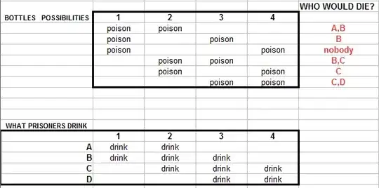

A simple solution for 1000 prisoners 998 dead
Number all prisoners and bottles 1-1000, and have each prisoner drink from ALL bottles except their matching number.
The 2 surviving prisoners have the numbers of the poisoned bottles.
** the bottles may be slightly depleted by the 999 prisoners taking a drink
We could also omit the last prisoner and deduce if only one prisoner survives the last bottle is the second poison.

What if we have two poisons in the same group of bottles?
As before, we can perform a bitwise operation, but this time for $n$ bottles is requires $2log_2\ n$ prisoners.
An example with $4$ bottles (two poisons) and $4$ prisoners is here:
Bottles are named $1,2,3,4$ while prisoners are $A,B,C,D$

  • @Falco explanation added, now it should be more clear to understand the strategy – leoll2 Apr 28 '15 at 12:55
  • @goldPseudo user2357112 answered correctly to your question. – leoll2 Apr 28 '15 at 12:56
  • @user2357112 I've added explanation of the bitwise strategy, hope it's enough – leoll2 Apr 28 '15 at 12:57
