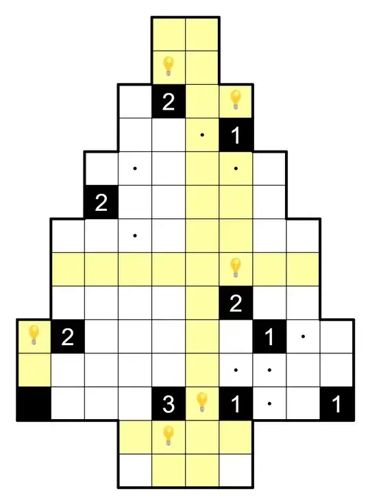

Once you reach this partial solution:
It looks like there are two solutions:
Hand-E-Food
  • 745
  • In your first one there is an unlit cell two to the left of the bottom-right 1... – Stiv Dec 20 '23 at 11:26
  • Look at the square to the right of the 1 that is right of the 3. It is unlit in your first solution. – fljx Dec 20 '23 at 11:27
  • Ah, thank you! It's been too long since I've played this. In my mind, if there's a dot then it must be lit some other way. But that doesn't indicate that it has actually been lit by a lamp. – Hand-E-Food Dec 20 '23 at 20:56
