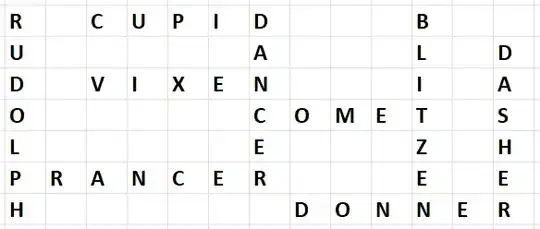

I've been able to do it in
7x13 = 91 Cells
You have to arrange the reindeers like this
I found it by generating and evaluating all possible arrangements. It feels like a really good solution, but I cant proof if this is optimal, there might be errors in my code.

The best I've been able to do has area
$7 \times 14 = 98$ cells
As follows
The idea here
is to try to make one of the dimensions small so expanding in the other direction does not cost too much. Frustratingly it looks like it could be made smaller if we move PRANCER to where VIXEN is and CUPID ending on the D in DASHER but then there is no good spot for VIXEN unless we disconnect it from the rest of the crossword.

I think I can do
96 cells in a 6x16 grid
because there doesn't appear to be a rule preventing me from doing this:
a grid featuring the monstrous reindeer hydra CUPIDANCERUDOLPH across the center
or at least there wasn't at the time I posted this answer :(

  • Hah! I did not intend to allow vertical-vertical or horizontal-horizontal overlaps in the name, but this is nice. I would begrudgingly call you the winner if this was the minimum size grid you could create, but fortunately for me there's an even smaller packing of the names that follows my intended rules. I'll clarify the rules to disallow horizontal-horizontal or vertical-vertical overlaps. – Aaron Windsor Dec 08 '23 at 17:55
  • yeah it definitely felt like it was against the spirit of the rules but at the same time I thought maybe this is the trick needed to solve the puzzle! back to the drawing board ig – juicifer Dec 08 '23 at 18:07
  • Another unwritten rule is that each reindeer must appear only once. – Florian F Dec 09 '23 at 15:20
  • I don't think either of these variants would actually help you even if they were allowed. I would be interested in seeing a solution that beats the winning entry that either does overlaps like @jucifer's or repeats reindeer. Doesn't seem like either will make the packing tighter. – Aaron Windsor Dec 09 '23 at 17:33
