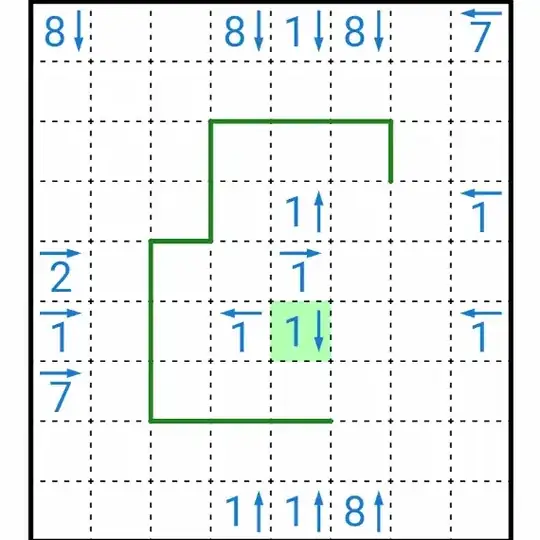

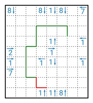

This picture demonstrates the mechanics of rolling boulders. The green squares show the path that the boulder rolls down. Note that there are sometimes multiple possible paths, but we only ever care about the one that rolls the deepest. The example outlined in red is an impossible situation, because a 1-boulder could roll down twice by falling to the right.

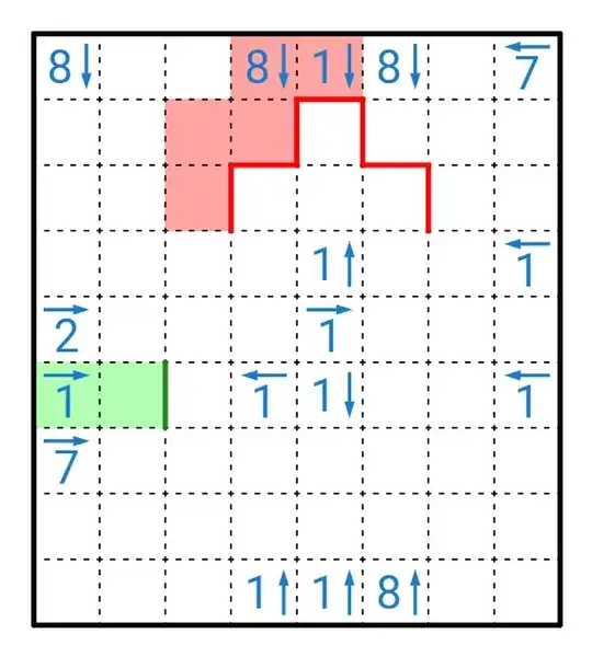

Here is the completed grid:
final image
The key to the success is
1s in between higher numbers.
Take a look at those 1s.
Their boundary should be directly below them, because otherwise they have to join with the adjacent numbers' paths which makes the ball roll down more than one cell; contradiction.
The next key step is
opposing 1s.
One can easily see that
those 1s should share the same border.
3 4
Things get easier after that.
5 6
Here is a gif showing the rest of the process.
