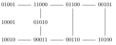

Here is a solution for $n \leq 6$ prisoners, where they are allowed to communicate using a device with $(n-1)!$ states, which I'll number from $1$ to $(n-1)!$. Call the cell number of the $i$th prisoner $a_i$.

  • $n = 4$: ($6$ states)
    • The first prisoner communicates $a_1$.
    • The second prisoner communicates the order of $a_1$ and $a_2$, along with information about the vacant cells. Consider the following graph whose nodes are binary codes with two $1$'s: enter image description here
      Two codes are joined by an edge if they satisfy the following conditions:
      1. There exists a position $i$ at which both codes have a $1$.
      2. The number of ones before position $i$ is distinct in both codes.
      This graph has a coloring with two colors, which means that the nodes can be colored with only two colors in such a way that no neighbors have the same color. The prisoners agree on a coloring of this graph.
      The second prisoner looks at which cells are vacant, assigns a $1$ to those cells and a zero to the other cells, and communicates the color of the binary code, along with the ordering of $a_1$ and $a_2$.
    • The third prisoner's cell corresponds to one of the $1$'s. Knowing the color of the binary code, they are able to tell how many cells are occupied before and after their position. This determines the ordering of $a_1, a_2, a_3$, which they communicate to the last prisoner.
    • The last prisoner now has all information, and as always communicates the ordering of $a_2, a_3, a_4$.
