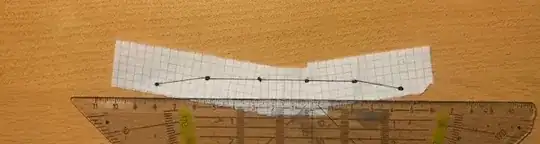

After proving that 3 strokes are necessary, here is a solution in 2 strokes!

  • OK. I'm impressed. I totally bought the 3 line argument. This is beautiful. – Joel Rondeau Sep 10 '22 at 01:50
  • I am accepting this answer. It is clear, surprising and optimal within my constraints; However, the other answers are useful too. They tackle the no-hole case. I do want to add though that those solutions do NOT work for the regular pentagon. Although not asked, and not proven by anyone: 4 lines are needed for a regular pentagon! – Retudin Sep 10 '22 at 10:56
  • This also lets you do it in 1 stroke if you cut the ring to open it. – Magma Sep 10 '22 at 12:11
