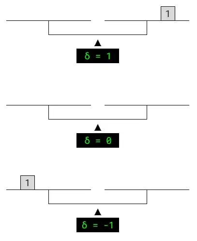

Step 1
Say we just have a 1-pound weight. What differences can we make? Well, we have only three options: we can put it on the right, leave it off, or put it on the left. So our possible differences are 1, 0, and -1.
scales in three configurations
(I've attached a digital readout to the scales - it measures the current weight difference and displays it at the base.)
