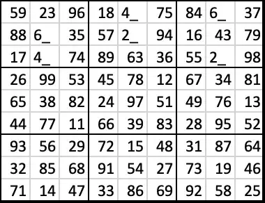

I came up with the same answer as @Dr Xorile:
Finished Sudokus
This one was actually pretty easy to do by hand in a spreadsheet. However it took enough steps that I couldn't undo all the way back to the beginning, so the first few steps are just going to be what I remember doing. I'll try to recreate the first part later when I have some time:
The first and most helpful thing I did after transcribing the puzzle was create a chart of all the numbers used so far. The extra information I could see in the chart made it a lot easier to decide what to try to figure out next.
My next step was just to look at each Sudoku individually and use very basic solving techniques. That allowed me to find all the 9_s and some others.
As soon as that was no longer bearing fruit:
I decided to look at the orthogonality constraint. Using my chart of used numbers, I could see that the 1_s didn't have too many left. By looking at the possibility for each 1_, I was able to solve for all of them.
More groups:
Next up were the 8_s, 9_s, and _9s, though I don't remember the order in which I did them. I think the 9_s were first.
(I have some pictures for this point on!) I was able to make a lot of progress on the second-digit Sudoku at this point
I was able to find all the _5s and some of the _3s:
_5s done and _3s progress
Another set of numbers finished:
I figured out the rest of the _3's and got 44 and 68 along the way. Pretty easy from here
It was at about this point that I didn't really have to look very hard for the next number to fill in. Just normal sudoku rules for rows, columns, and cells, using the chart of used numbers as a guide for where to aim next and quickly narrowing down possibilities.
Finally, almost done:
I got to this point and saw that it looked underconstrained, and finally noticed that I'd missed transcribing a clue. Trivial to solve from here once I put it in
Almost there
Rob Watts
  • 5,966
  • 39
I believe the answer is:
59 23 96 18 42 75 84 61 37
88 62 35 57 21 94 16 43 79
17 41 74 89 63 36 55 22 98
26 99 53 45 78 12 67 34 81
65 38 82 24 97 51 49 76 13
44 77 11 66 39 83 28 95 52
93 56 29 72 15 48 31 87 64
32 85 68 91 54 27 73 19 46
71 14 47 33 86 69 92 58 25
